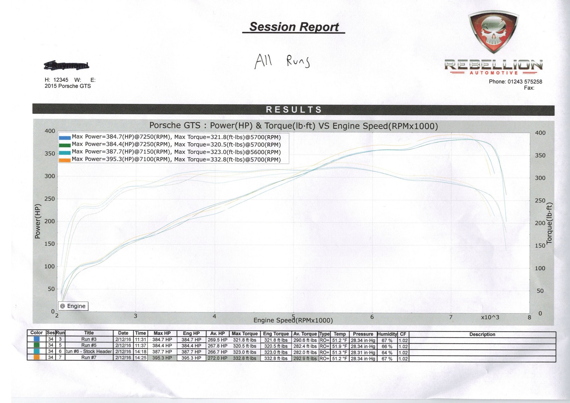

Thought I should chip in with some 'buyer beware' info re aftermarket parts. I had the Fabspeed sport headers (the ones with the 200 cell cats) on my 991 GTS and had to return the car to stock to get some warranty work done. I liked the sound the headers added, but was never sure whether the increased power I 'felt' was just due to that, or whether anything meangful was being added, as Fabspeed claimed. I took the car down to Rebellion Automotive, my long-time tuning shop who installed the headers and who now have a dyno, and they carried out ten runs, including warm-up and adaptation, then two test runs with the Fabspeed headers and two with the car returned to stock.
Here is the readout for all four runs.
Points to notice: 1) The car seems to be producing a lot less power than Porsche claims. This may have something to do with having to run the dyno in 4WD mode even though the car is RWD, because 991s freak out if the rear wheels are turning and the front wheels aren't. Whatever the reason I'm not too bothered. I don't think my engine is defective or my car too slow!
2) The torque seems to come in really early. Sure 'peak' tq is at over 5,000 which is where Porsche says it is, but we're getting most of it by 3k, and well over 2/3 of it by 2k. This seems to provide some evidence against the GTS engine being 'peaky'...
3) The curves look pretty darn similar. Rebellion said that all were within the margin of fluctuation for dyno operation. I'm afraid that, other than making the car a bit louder, it doesn't appear that the Fabspeed headers do anything.
This becomes more uncomfortably evident when we compare the best Fabspeed run (the first) with the best stock run (the second).
The car puts out 10hp more at peak with the stock setup. Rebellion said they wouldn't call this sufficient evidence that the stock headers are superior (margin of fluctuation again), but that there is definitely no performance advantage to using the Fabspeed ones on a GTS. This seems particularly true because there is no change in the shape of the curve - no ironing out of the dip at 2.5k for example. Also, I know Porsche ECUs adapt to mods, and we didn't do more than warm the car up thoroughly on the dyno after we changed the headers over, but it seems noteworthy that it was the second run with the stock headers that was the better...
To be fair to Fabspeed, their website uses a readout for a C4, not an S, and not a GTS,
and no specific claims for the GTS are made. But when they sold me the headers they knew I had a GTS and did claim power would be increased.

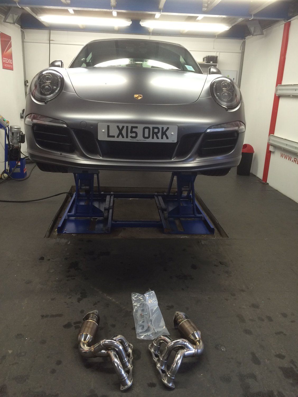

I was also surprised by the appearance of the headers when we took them off. On November 17 they looked like this:
But less than 3 months later, this:

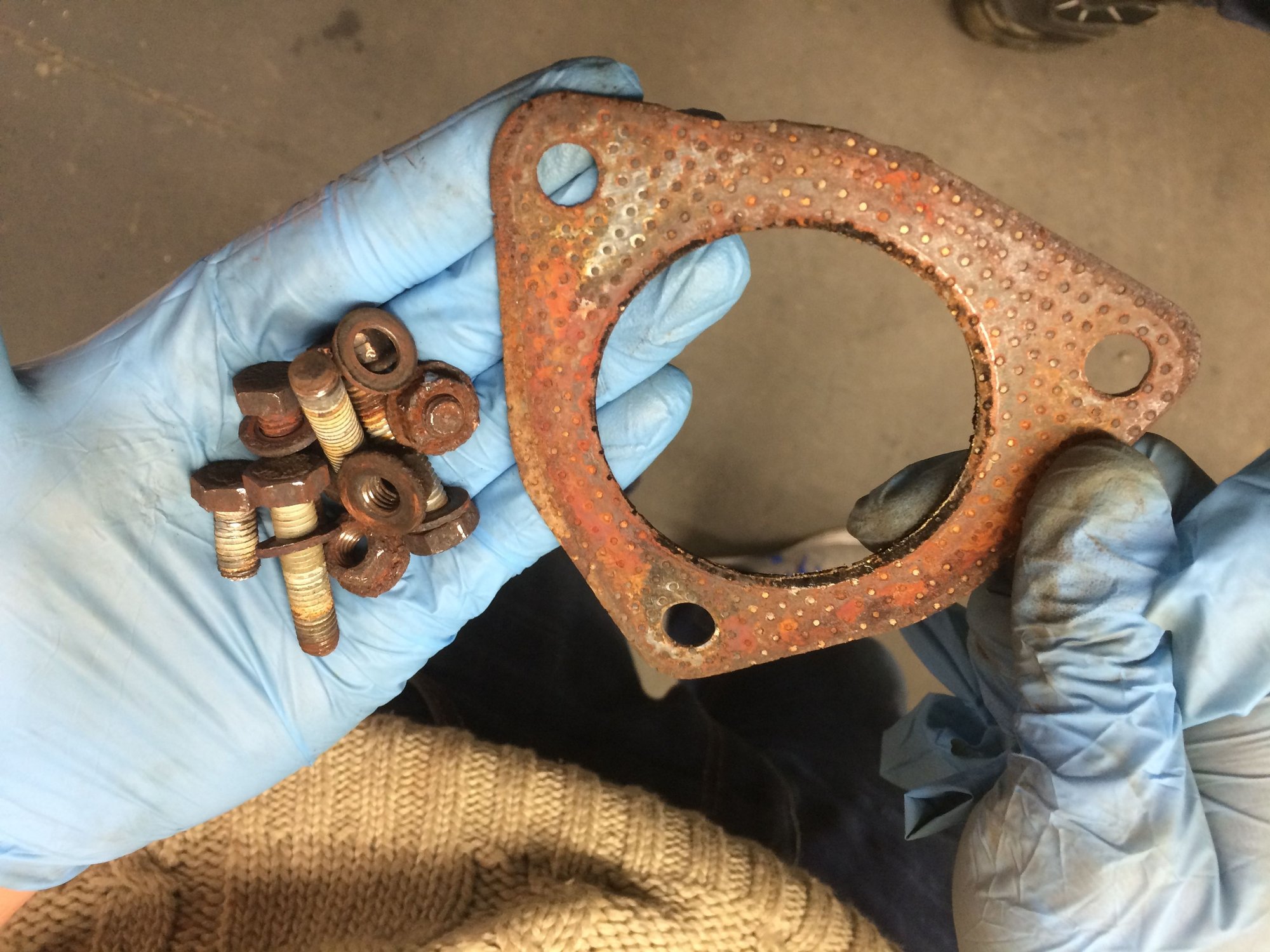

and this:
A number of the bolts were so corroded that they snapped when being undone. After less than 3 months' use.
Let me be clear that I enjoyed doing business with Fabspeed and they were never anything other than courteous, quick to reply and helpful. I do not feel I was deliberately misled, but am nevertheless disappointed that this particular product, which has a list price of $2,995, was in my particular case was both of lower physical quality than it first appeared and failed to perform half of its advertised function (increasing power).

Wow, thanks for sharing Magic Rat..and im sorry to see the dyno results you found. Not cool. I'm considering Fabspeed's carbon fiber air intake for my 2012 997 GTS. ..Fabspeed claims around 15hp gain. Your experience does not bode well on my decision process.

Just wanted to let everyone know of a development. Fabspeed got back to me, and it seems that they do indeed stand behind their products. After I directed them to this thread they said they were going to get a GTS into their shop and test out the headers on it themselves. I'm guessing they replicated my lack of result, because a couple of weeks later I got a call saying they had developed a sport header specifically for the GTS (the ones they sold me were developed for the S, but apparently GTS exhausts were the same as S ones in previous generations, so they expected the same results). I think the difference between the two is just a wider-aperture 'hi-flow' cat, but stand to be corrected by Fabspeed if it's more than that. Two weeks seems like an impressive R&D turnaround if it is...
Interestingly, when my tuning shop were changing headers about, what they noticed was that the aperture on the cat was narrower on the Fabspeed header I had than on the stock one. I wonder if this is a difference between the GTS and the S, and what causes the slight difference in exhaust sound between them.
Fabspeed are going to take back the headers they sold me for a refund and replace them (at a pleasingly solid discount) with the new ones.
As far as the rusted state of the fastening bolts go, they seemed as mystified as I was and said they'd never had a problem like this before. I am sending the old bolts back with the headers so maybe they can shed some light when they've seen them.
Overall, though with the big proviso that the new headers perform as advertised when I fit and test them, I'm pretty impressed with how Fabspeed have dealt with this. They took the data I sent them not as a threat, but as a piece of scientific information, and made sure the inconvenience I've gone through was compensated.
I will publish results here when I have them, but in the meantime here is Fabspeed's claimed graph for the GTS sport header.
Hopefully we GTS owners will now have a product that truly improves our cars.
