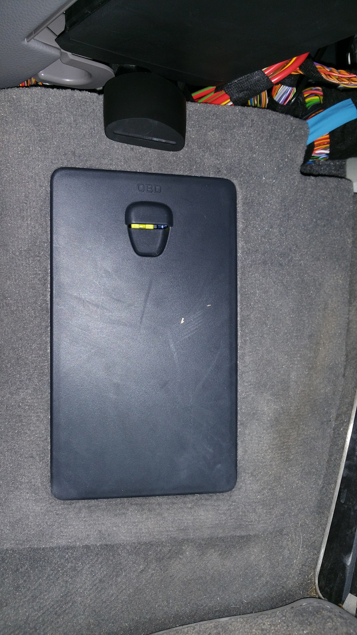

Installation:

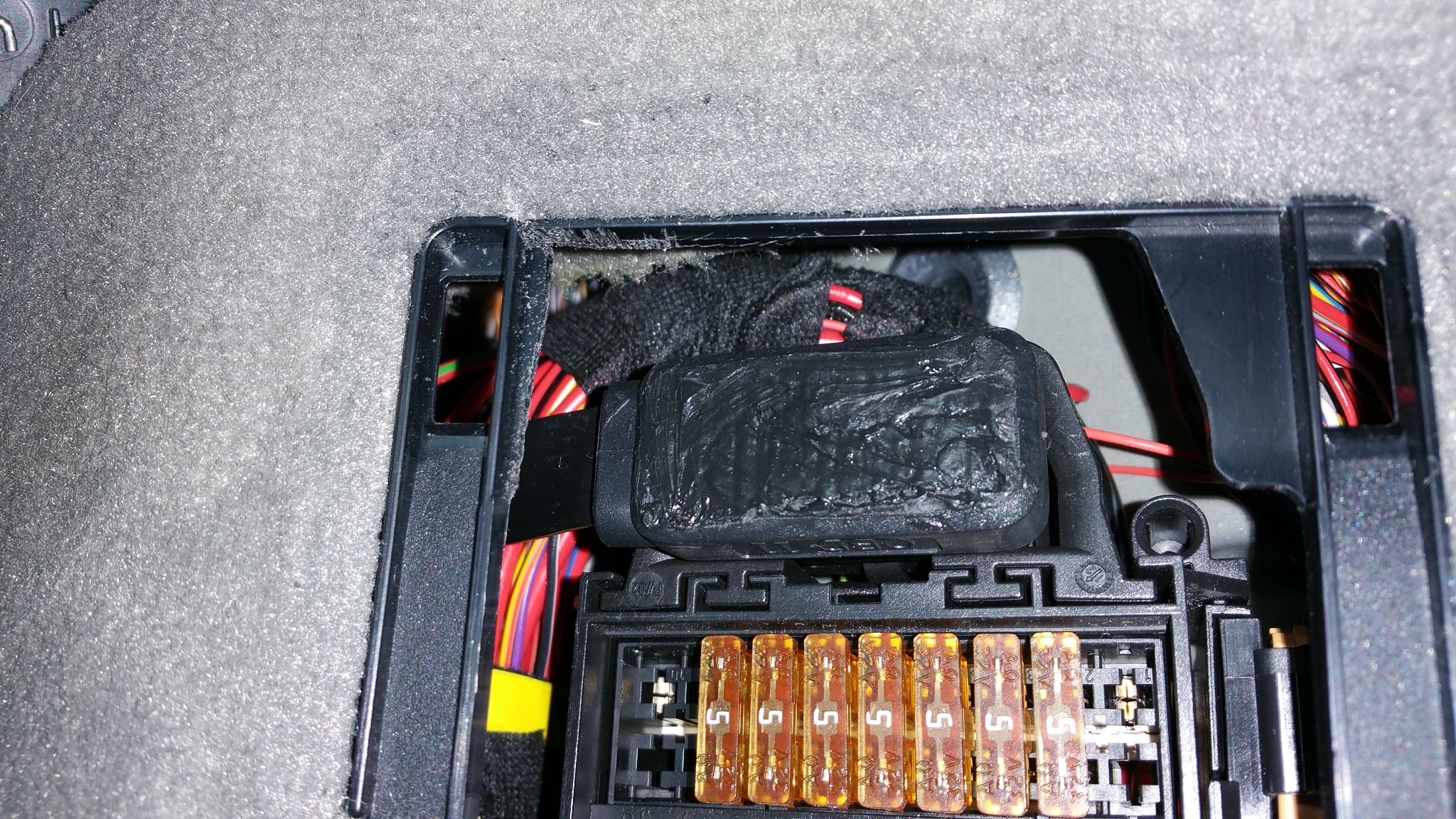

When the backup camera arrived, I initially plugged the car adapter into the OBD II port and left the fuse cover off. Tomcatz suggested I get a flat wire cable and I did, but I didn't notice the part that plugs into the port had another port coming out the other side which made it too large to put the cover back on. I ordered another cable without that, but it still extends up a bit to extract the wire. Since this cable had a side mounted wire, I cut the extra port off the top as shown in the picture. I'll try the other cable when it comes in but it is coming from overseas so it may take a while.
Fortunately, the pins were submerged in rubber so they cut clean and I sealed them with silicone. The OBD plug fits and the cover can be replaced as normal. I ran the wire to the top of the panel and secured the new OBD connector out the top. You can see it with the car adapter attached. The one issue was because of this particular flat wire plug I had to trim part of the fuse cover bracket on the bottom right as it interfered with the wire (see picture).
The camera performed as designed using its own Wi-Fi which takes about 4-5 seconds to load. When I turn the car and app on as I get into the car it is usually ready by the time I want to back. If the phone has been turned off, activation takes about double that time.

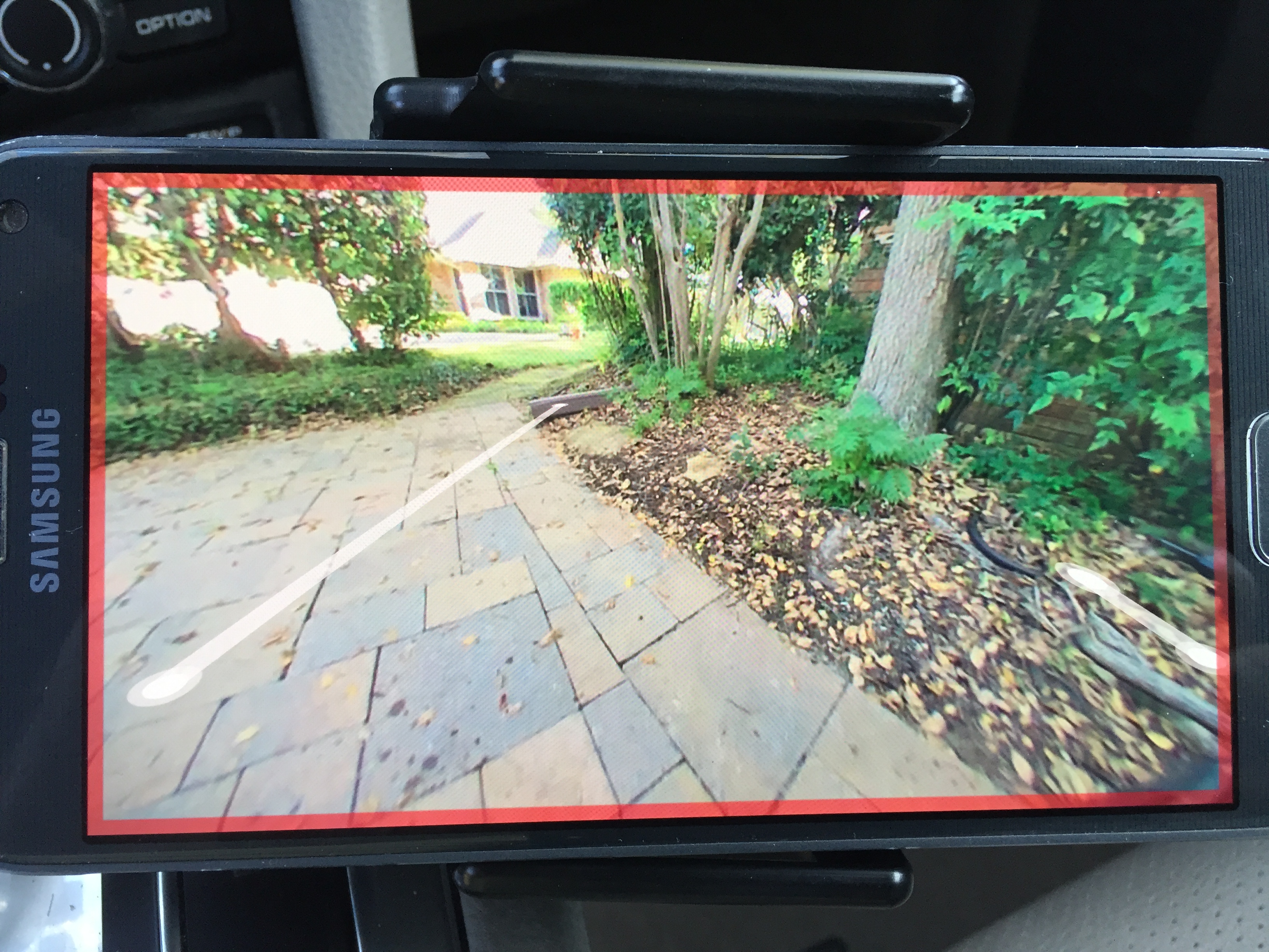

Initial impressions
Pros
Excellent day and night picture quality
Easy installation with excellent installation instructions
Great warranty- 3 year with 30 day no questions trial period

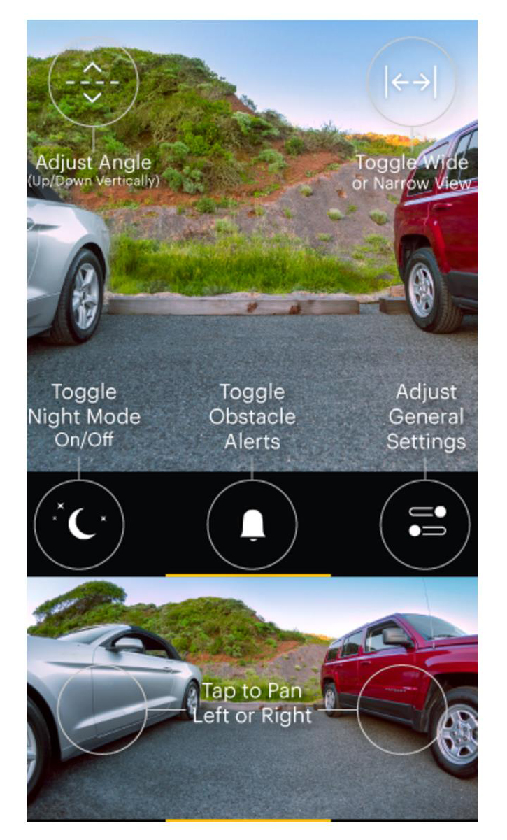

Wide field of view (top picture) and field of regard (bottom picture)
Electronically adjustable in elevation and azimuth

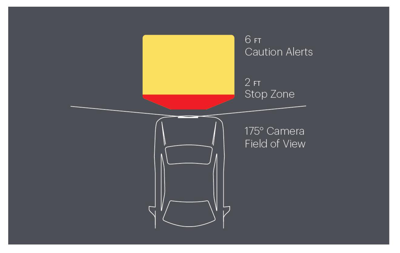

Sound and visual alarm notification for both backing into an object and vehicles / walkers approaching from the side using the camera’s image movement technology in the FOV
Battery strength indicator in app
Lower cost than hard wire retrofit
Excellent theft protection- unique “key”, frame will only work with integrated OBD car adaptor and the frame is warranted if stolen
Wide and super wide views on top and bottom of the screen in portrait mode and field of regard is movable by a tap on the FOR screen. In landscape mode, only the wide view is shown where the FOV is just slightly less than the FOR screen in portrait mode.
Product updates available with software upgrades on the app
Excellent and responsive support
Shortcomings
Alarm could be louder (especially initial warning)
OBD II device if installed directly into the socket sticks out 1” and would require cutting a hole in the OBD cover or adding side mounted extension wire (see pictures)
No detailed operating instruction available (however use is very intuitive)
No backing lines (planned in a downloadable software update by November)
Still left with a much smaller screen than a factory system
The software is stable, but in some parking lots with stores that have WiFi there have been a couple times the picture flickered
Deficiencies
None noted yet
Clearly, this is not as good as a factory unit (or hard-wire product integrated into the dash), primarily due to the screen size and non-instant-on operation. It is, however, very satisfactory (especially having side and back object sensing) and it was significantly less expensive than a factory system. I keep my car in the garage and do not drive it daily so it will be interesting to see if the battery stays charged. Fortunately charging it manually is quite easy. The graphic shows 175 degrees FOR, and it is quite wide but that may be slightly less depending on how it is mounted.

Question for those of you who have one. Do you have to cut or modify the fuse box / obd. I got the flat wire adaptor from amazon and was hoping I could stuff it somewhere or hang it over the top without cutting.
