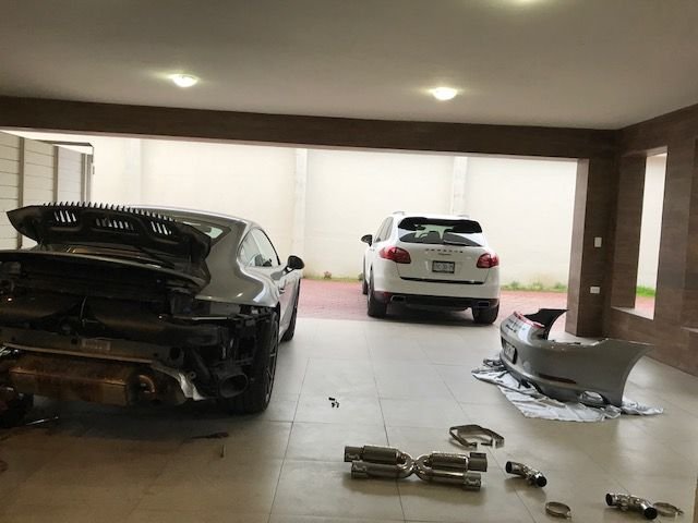

Received it 2 weeks ago and instaled it as fast as I could.
THE INSTALL:
Was a bit more than expected, but got it done in about 5 hours. Mainly because the hardware provided by fabspeed for the install was incorrect.

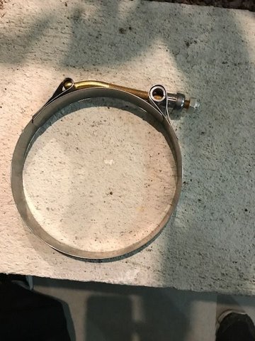

There are 2 clamps that hold the x-pipe to the car, but the ones provided were just to small and couldnt be closed or adjusted, so had to run to Home depot to buy some.
After that, contacted fabspeed about it, so they would send the right ones, as the ones I got in home depot were not automotive grade ones. But the aftersale customer service with fabspeed is not the same as the pre-sale customer service.
They just said the clamps provided were the correct ones, and that was that.
I was there during the install and I can asure you, they were so small they couldnt even be closed to grab the x-pipe.

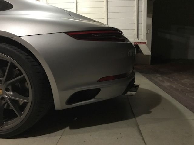

THE FIT:
We finished the install, but when we fitted the exhaust tips, I was far from impressed.
The stock tips steped out about 2 1/2 inches from the bumper.
Lets say the look was far more RICER than I could take. So next they I had to go to a Muffler shop, were they cutted 1 inch off the piping, so that they could get the exhaust tips within tolerable distance. Now they are 1 1/4 outside of the bumper, wish is tolerable.
I had to pay 150 dlls to get them to fit right, to wish fabspeed customer service said, that the tips being 2 1/2 outside of the bumper was perfect and that it was to prevent damage to the bumper. Not quite what I was looking for my luxury sport car, may have been correct for when I was 16 years old and had my HONDA CIVIC.
Does this look like a correct fit, the tips a 2 1/2 inch out of the bumper.
Inside the exhaust tip, were the muffler shop cutted 1 inch off the pipe
This of course was after cutting 1 inch off the pipe, before it was ridiculos.

INCORRECT HARDWARE FOR THE INSTALL PROVIDED BY THE SELLER
AND ABOUT THE CUSTOMER SERVICE, one of my worst Online experiences of the AFTER SALE CUSTOMER SERVICE.
Before you buy, John Gaydos is of great help and answers all your questions immediately.
But when things went wrong after the sale, didnt get any response after 5 days, and then he pass me to after-sale customer service with BEVERLY Schaible, which job is just to tell you that everything is correct and that you are wrong.
Would have been happy with a correct set of hardware CLAMPS, but couldnt even get that.

I just looked at the website, it seems like they make an adjustable set of tips for their x pipe/muffler delete setup. Is there adjustability on the OEM tips.. there's no way, regardless of what the support rep. said to you on the phone, that the tips should stick out like that by design.
Im guessing they designed it for use with their tips and didnt want to dsicourage potential sales by saying you must modify OEM tips if your wish to retain them.

The replacement clamps later on got really rusty and a bit scary. They ignored me after saying they are not covered by warranty. Once Chuckj took notice, the fabspeed people stepped up and sent me new ones. It's a shame they need to get slammed here for a few days... they do have solid engineering, but as I said before in that particular thread, customer service can taint all the engineer efforts and investments.

I've had my Fabspeed x pipe for almost a year. Is 100% louder than a PSE valve open. Trust me, I've been to many Porsche events. My tips stick out more than I would like, but not nearly as much as your photo.
