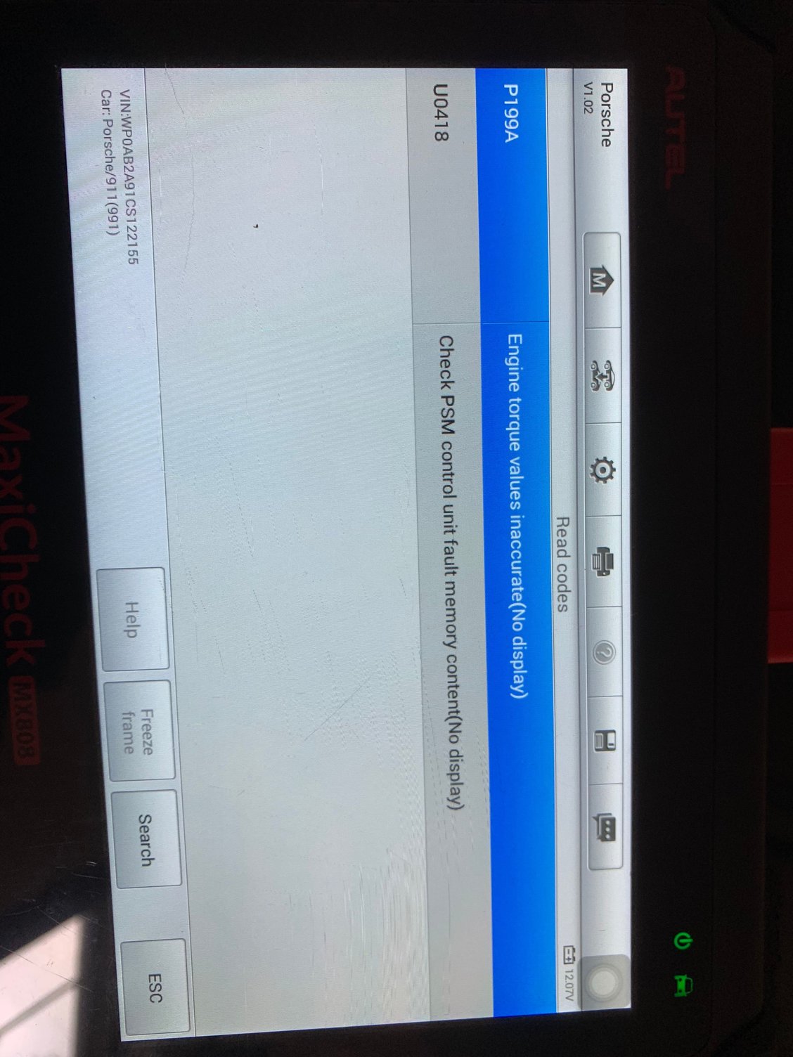

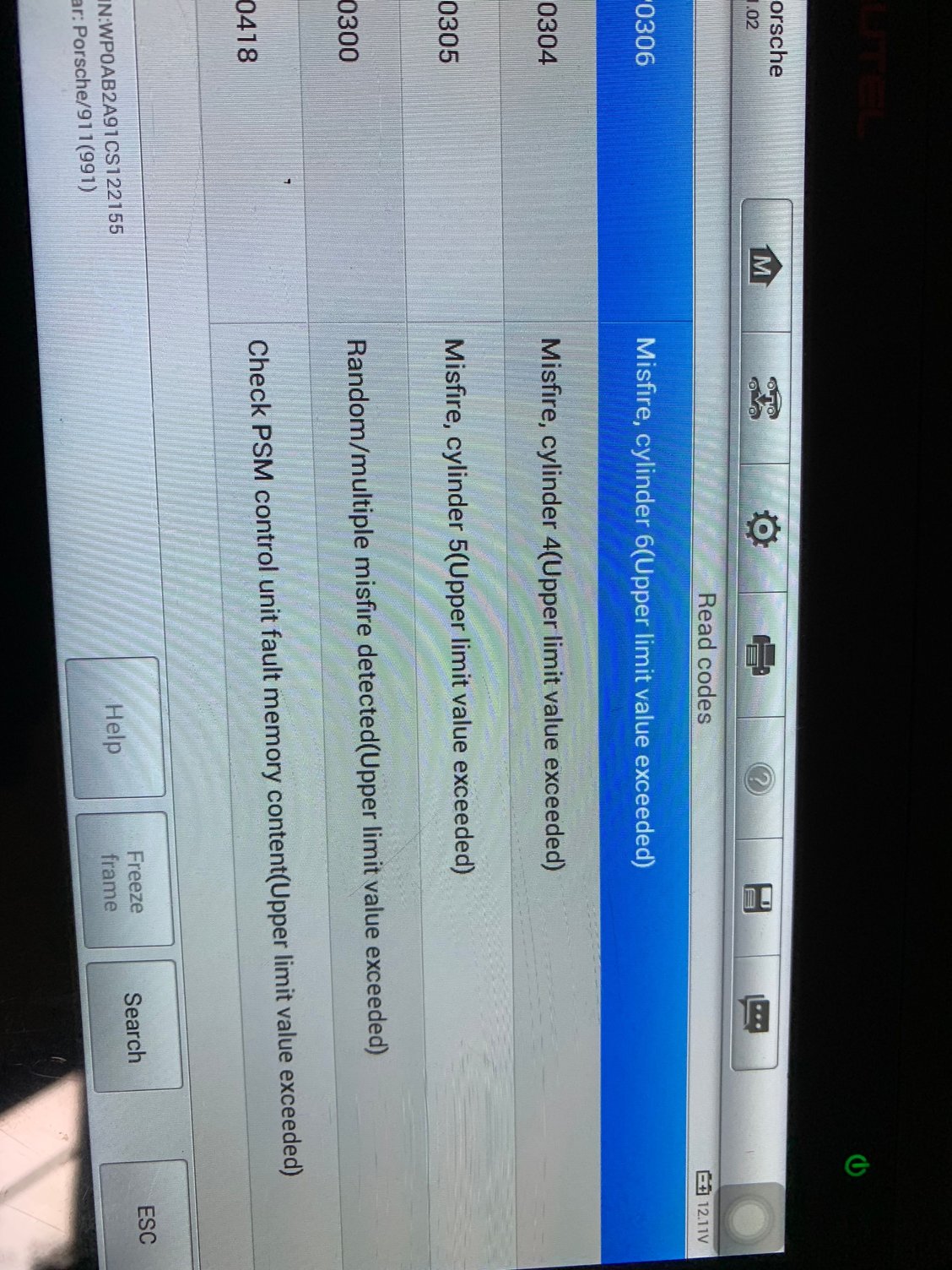

Got the same problem
My warranty just expired a month ago, I recently got the same problem. I have replaced all the spark plugs and coil packs, reset the codes and then the car starts perfecltly and drive with no problem within 20 min or around 10miles. But it will start to shake during idle and you can feel the CEL is coming soon. Bang ! It comes with a lot of shake and I drive it home slowly.
The code from transmission
The code from DME.
The misfire code will still pop up even I changed all set of coil and spark plugs. anyone can can help me ? Maybe the Hydraulic valve or O2 sensor ?
Take it to the dealer, spend some cash. They will clear it and it should go away like mine. Others have told me it will return - I hope it was from not driving it.
