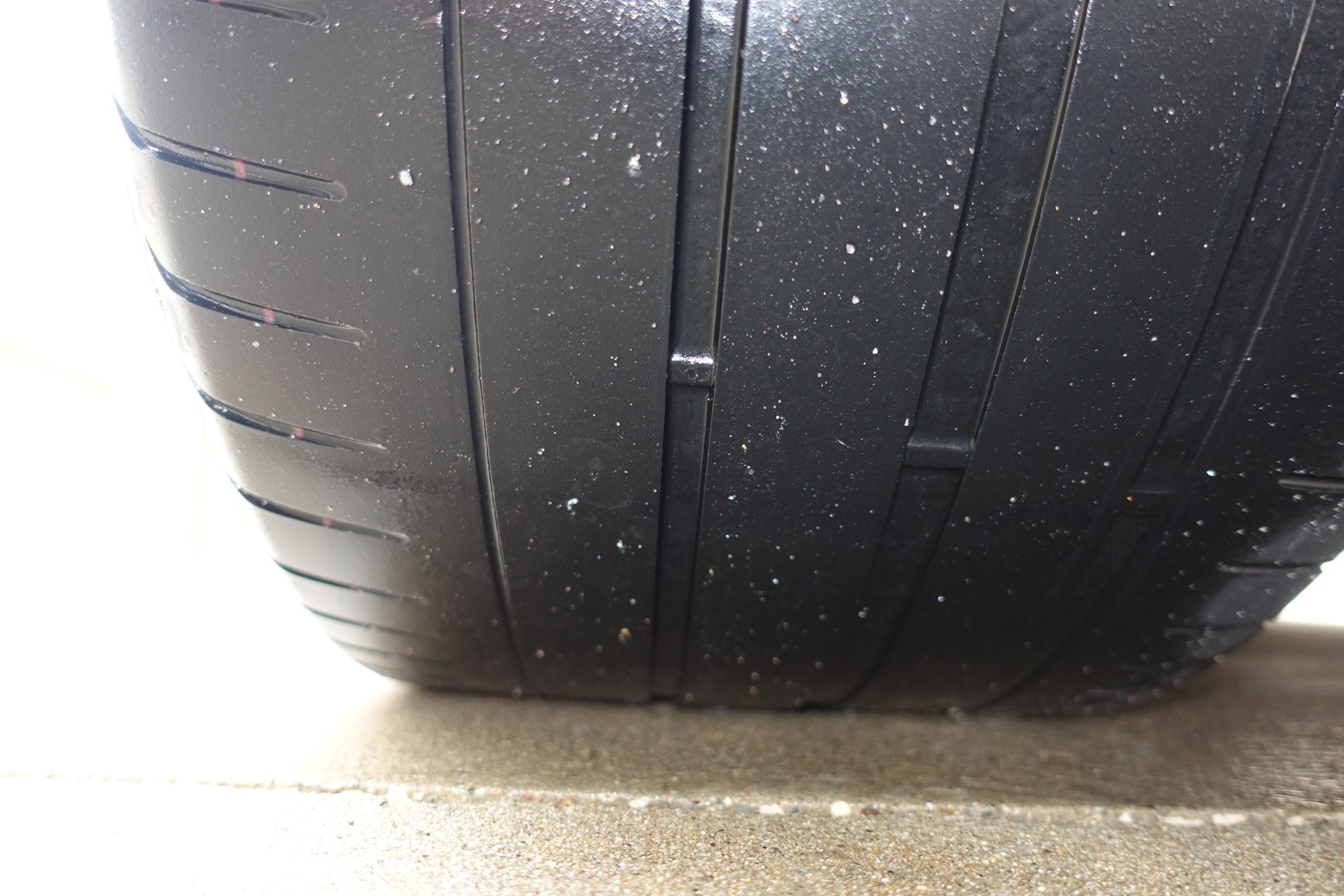

These are my Pirelli P Zeros after 9,000 miles. Down to 2/32 seconds so Michelin PS 4's are going on today.
