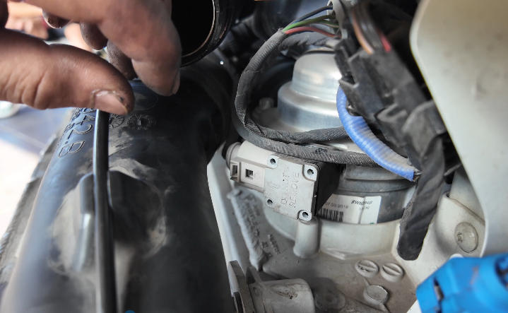

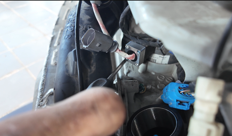

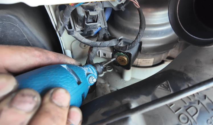

Porsche 911 991.1 dashboard displayed “PADM deactivated. Service required”. Reading the fault code indicated a short circuit in the left engine mount. The issue was resolved after replacing two sensors.

The sensor on the bracket is damaged, the fault code is 001013 or 001023, and the left or right side shows a signal short circuit.
