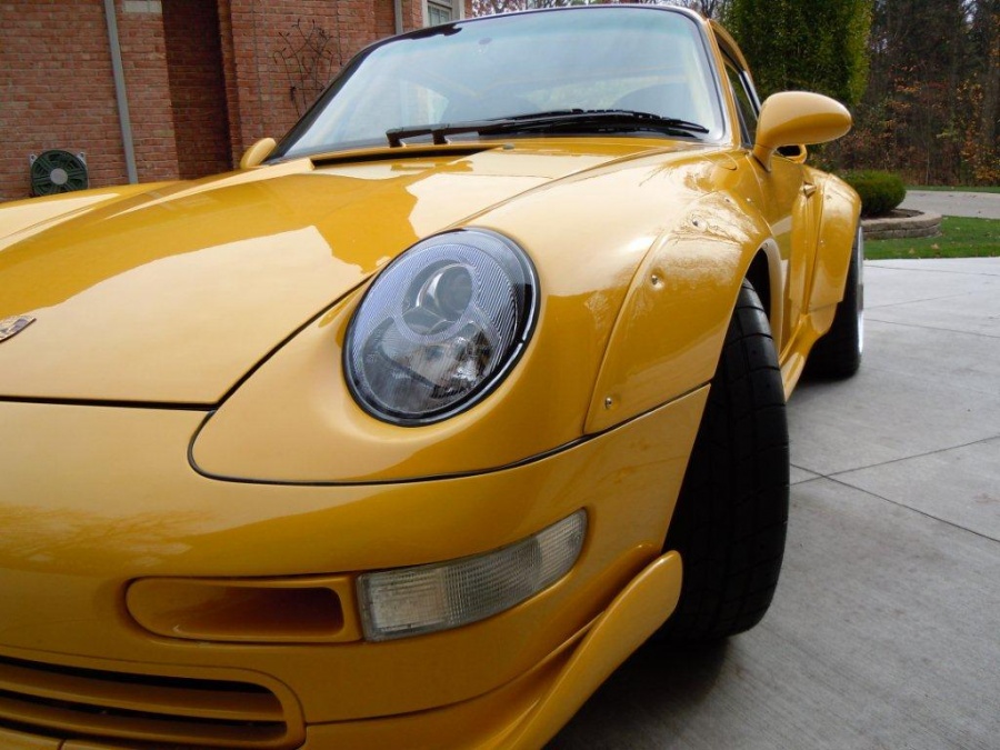

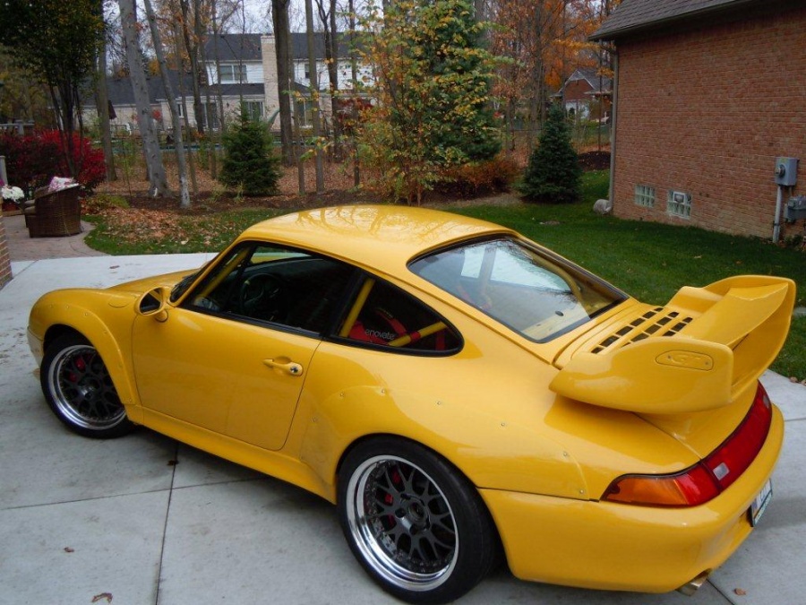

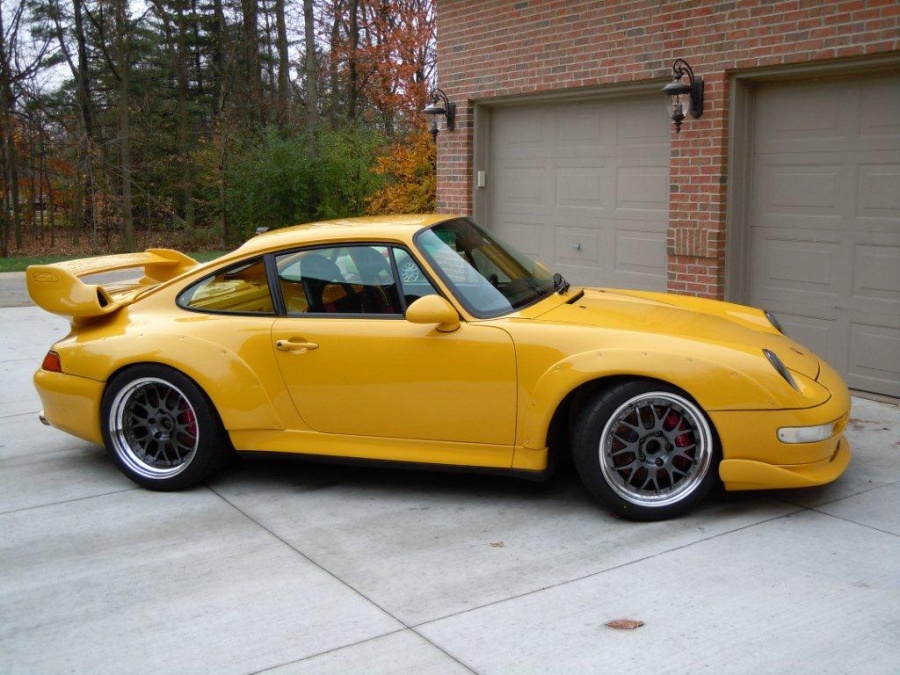

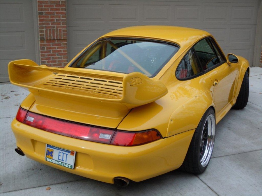

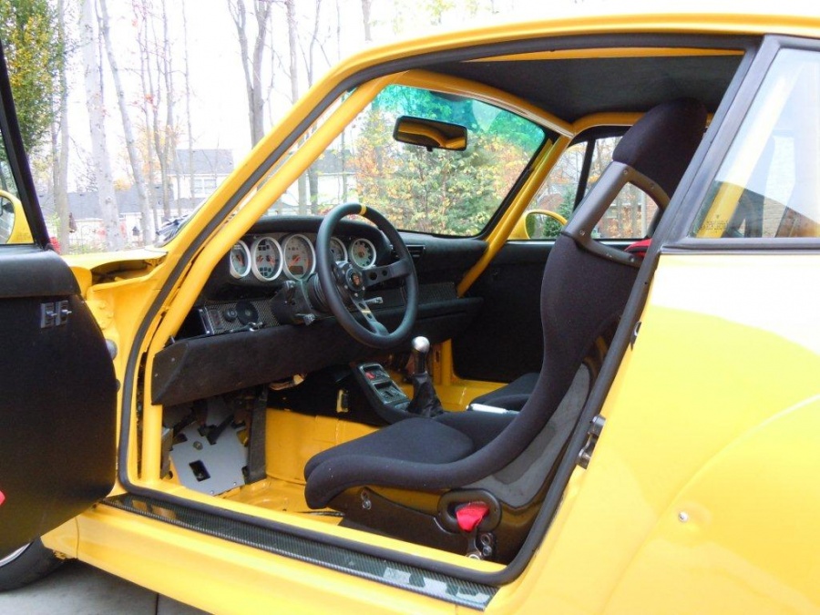

new photos of GT2 clone
I completed the conversion last year.

Very impressive! How did you find all the parts? Looks like a GT2 to the teeth! Congrats.

There are several companies selling fiberglass reproduction parts. The key is the fitting and the amount of work it takes to make the pieces look good. Cant just paint and install. The front bumper is NA Porsche with a fiberglass splitter. It was quite a job cleaning all the old adhesive from the carpet and sound insulation in the interior. I think I spent close to 40 hours just prepping the interior.

Engine rebuilt using Pauter light weight connecting rods, new piston & ring set, Schrick cams, crank, oil cooler, Sachs Sport lightweight clutch, flywheel, pressure plate, Fresh air intake with K&N Filter, ECU by GIAC. Rebuilt Turbos K-24. Muffler delete with Fabspeed tips.

Tires & Wheels:
Forgeline Motorsport WC3R 9 X 18 fronts 12.5 X 18 rears
one track day and 800 street miles on tires
TOYO Proxes RA1 245 40ZR18
TOYO Proxes RA1 335 30ZR18
Exterior:
Complete original Speed Yellow color respray Sikkens paint, GT2 Body kit, Sunroof delete, headlight washer delete, rear wiper delete, 3rd break light delete.
New bosche headlights
Interior:
Stripped and painted interior, Full roll cage, aluminum floor mats
Porsche 996 Euro GT3 Recaro cloth seats , Schroth 6 point harness
with GT3 seat sub strap rail
Porsche GT3 seat belt harness, Alcantara head liner, Alcantara dash console, lower dash and center console. Momo steering wheel, Porsche Carbon Fiber dash overlay, Carbon fiber door sill, carbon fiber shift ****. fire extinguisher mounted on roll cage, radio delete, airbags removed,
RS door panels
