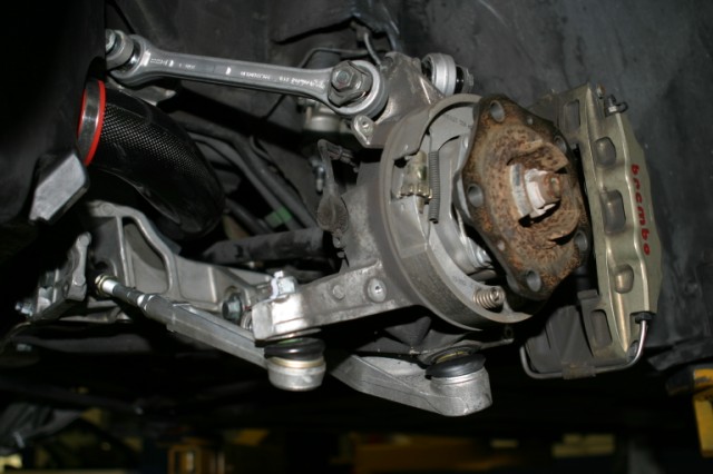

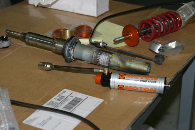

xico is infamous around these parts
day 1 loose components
the whole suspension came in small pieces
pic 2 day 1
more pics

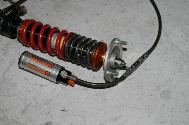

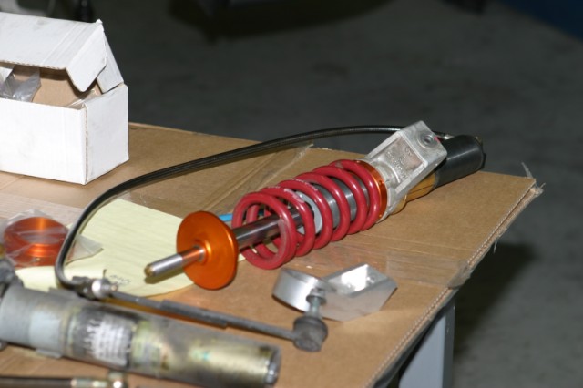

day 2 moton clubsport assembled
moton's assembled

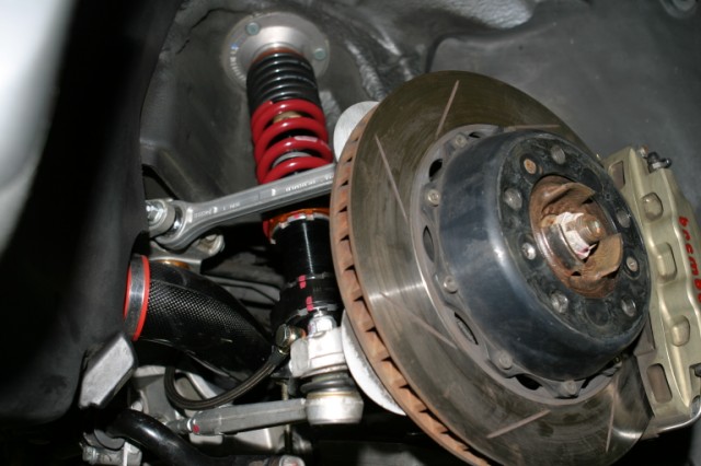

gt3rs rear suspension
all the rear suspension components are exactly like a GT3RS car

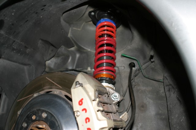

day 3 suspension installed
picture 1

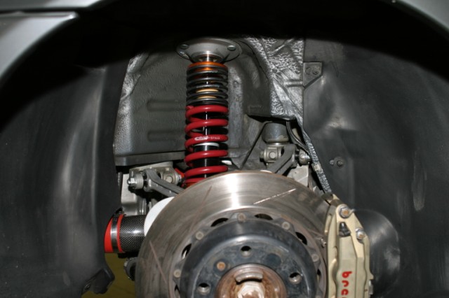

day 3 picture 2
day 3 picture 2
day3 picture 3
day 3 picture 3

Xico,
I have some questions....
  1. What spring rates are you using in the front and in the back?
  2. Where will the remote reservoirs be mounted in the front and the rear?
  3. What ride height will you set the car up to? Please reference the ride height measurement points under the car with your answer.
  4. Is the system 2 way or 4 way adjustable?
  5. Would I be correct in assuming you are running the GT3RS sway bars as well?
  6. How are you handling the front axle shaft interference with the sway bar drop links when at full steering lock?
  7. Are you replacing any front suspension parts similar to the rear GT3RS parts?
Please post as many pictures as possible!
Oh, and congratulations on your UPGRADE!!!! I want a full report after you drive it.

xico's Avatar
Exotic Performance
Joined: Dec 2003
Posts: 341
From: south florida
Rep Power: 36

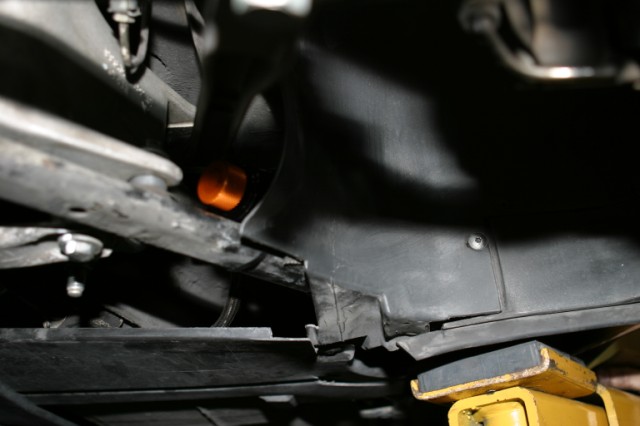

some data on suspension
the spring rate is 600lb front 900lb rear.
front mounting of reservoirs under hood
rear mounting of reservoirs down below in rear (see picture)
ride height is 110mm
system in a moton club sport 2 way adjustable
sway bars are large H&R with racing adjustable drop links
some front control arm pieces are from GT3 Rs as well
engine mounts were replaced with more solid ones from the X73 sport package

I have been up to Orbit Racing with XICO everyday this week. Roger mentioned that this was a (2) way adjustable. The canisters for the front are in the trunk area, the rear are in the back of the passenger. The ***** for the rear suspension are under the car (which is the pic directly over this post)
