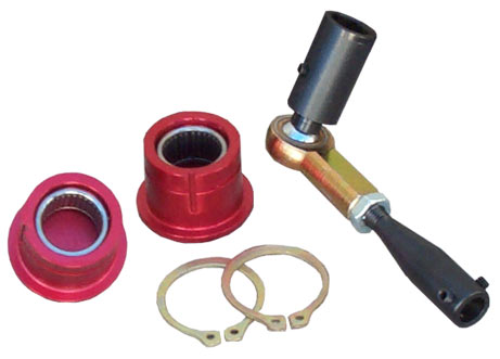

Yes that is the little bastard part that has broke on me twice and caused me a lot of heartache. How Porsche can put that cheap piece of plastic on the shifter to hold it to the linkage is beyond me.
So the EVO replaces that with a metal part correct? That is what I want, no more plastic is breaking on me.

The EVO shifter replaces the plastic part with a machined spherical heim joint. There is no way to break it. Sorry to hear about your bad experience at the track.

The heim joint will not work by itself. The hiem joint kit, which includes the shifter extension, is $130. Another problem with the shifter is the plastic bushings. This was the reason that we designed machined aluminum bearing cups with needle bearings to prevent breaking them as well. These are supplied with our complete SSK system for $230 or available separate for $110.

Just keep in mind that if you put in the extension/joint to get rid of the plastic shift connector then you will have a short shifter. Jeff

You are correct. This shortens the shift by 18-20%. We are in the final CNC machining stages of a replacement shift lingage that will replace the OE plastic linkage. They will be bullet proof and will have the available in a few weeks.
