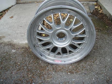

I´m going with BBS Cup centerlooking rims with 255 Toyo R888 in front and 315 Toyo R888 in the rear!
