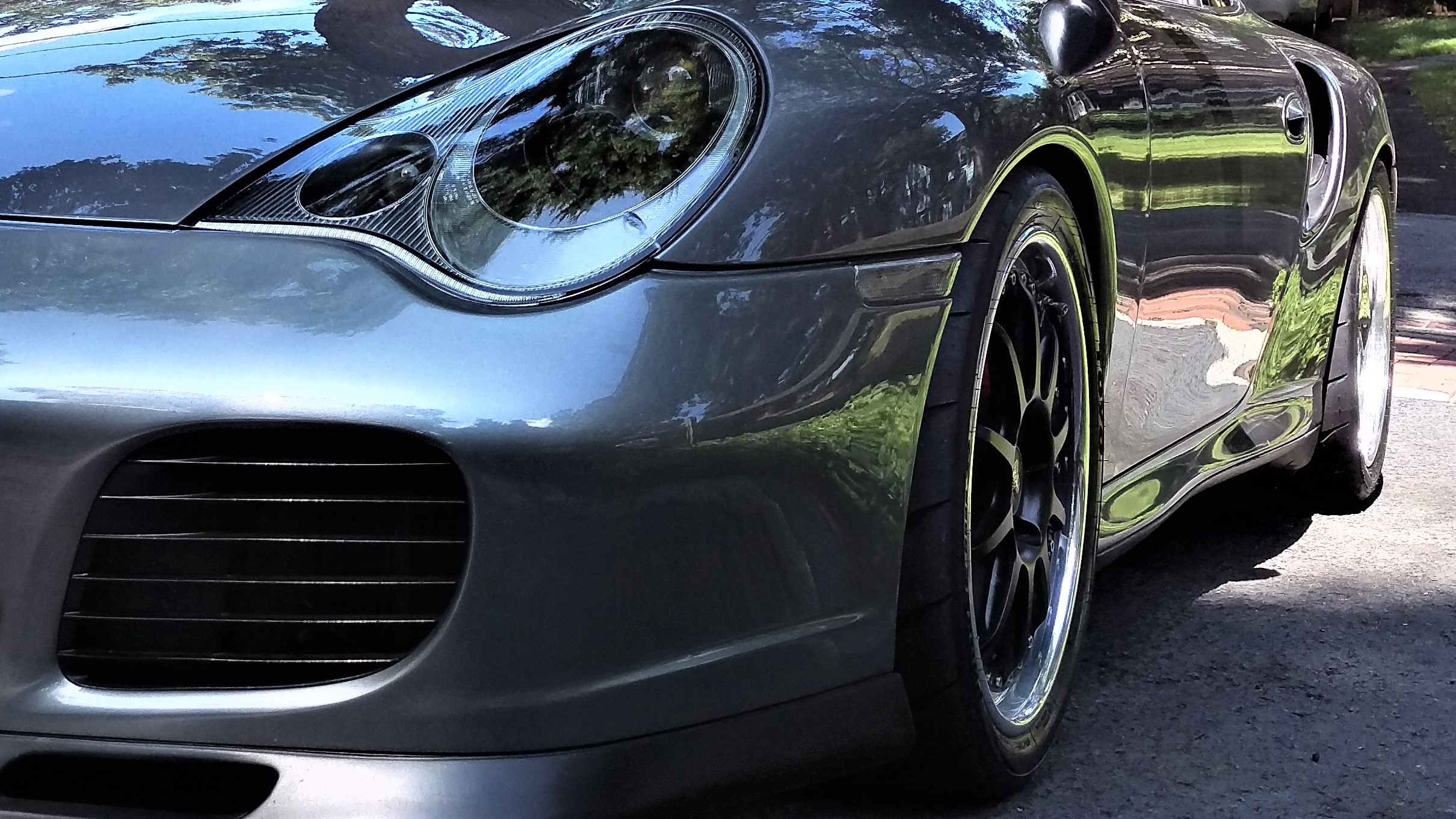

255-35-18 Toyo R888R on HRE 18X8.5. Just factory rolled fenders no other work.
