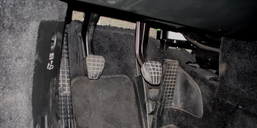

Here is a reference pic for the end product... I apologize for the car being FILTHY, very bad weather the last few days... and yes i'm getting new pedals and rest plate
