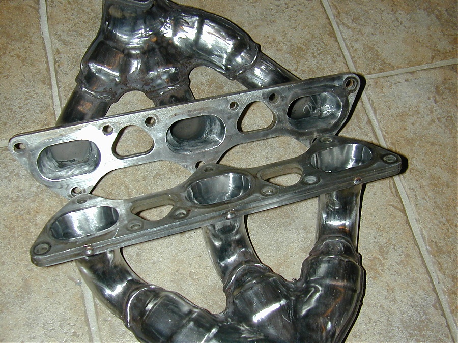

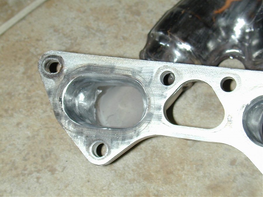

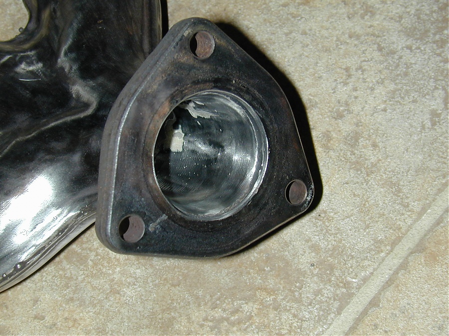

I had my stockers kicking around collecting dust and dirt, so after reading many posts on the subject I decided to port them. I am not selling them but here is a few pics that may give you a idea. I will say these were hard to port, the material I mean, very very hard SS.I will say there is more to come out of there then you think.Try it, I am sure it will help!

Those look great.
What bits did you use?

Thanks, I went thru ALLOT of bits...this material was HARD, I used a Course 50 grit stone, then 80, then 120, then 160 to polish. I used a air grinder with a rather large compressor, I did these at one of my manufacturing plants. I think I have around 5 hours into them. If I were going to use them I would have them ceramic coated for sure.
