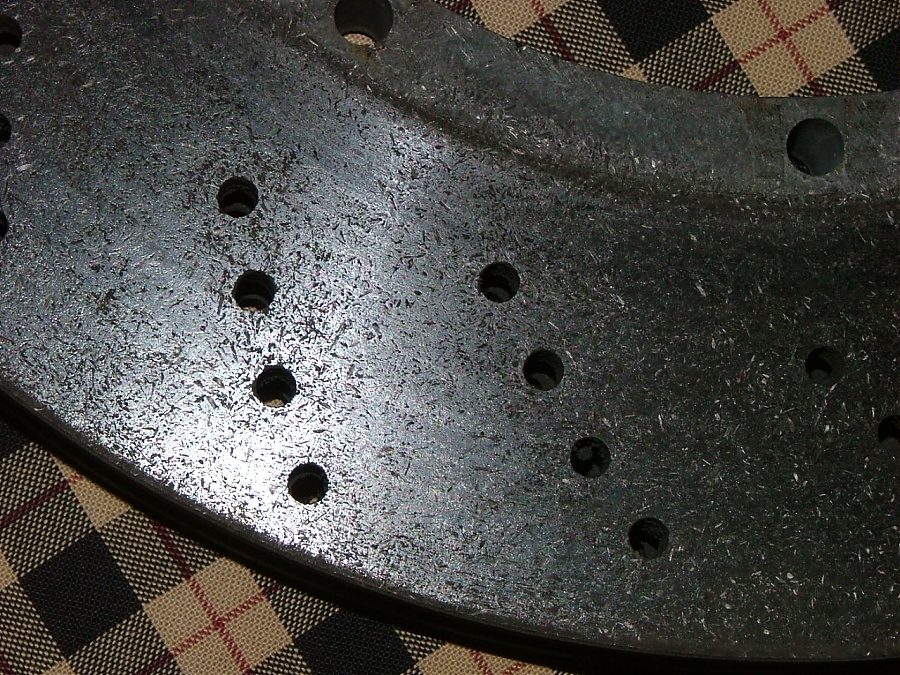

Does anyone have a worn set that they could take a picture of?

Here are three photos:
New rotor has semi-glossy surface with light cross-hatched pattern. (photo of disc without hat)
Second photo is rotor with some heavy use, but thickness still in spec and functional. (rotor is mounted on car)
Third photo is rotor that is pretty much worn out. Semi-glossy surface gone. Would still stop the car but would eat pads quickly. This one was at or below the wear limit.
Hope this helps. Also would like to invite more experienced 6-speeders to comment.

Thanks so much for your efforts Superchicken!
So aside from the thickness it seems that the more shiney they get the more worn they are?

No, it's the other way around. The pic on the right is the newest rotor.

Correct, Adam. Photo on right is newest (about 1000 miles). Center photo about half-used up. Left- side photo is the worst.
Sorry for confusion.
