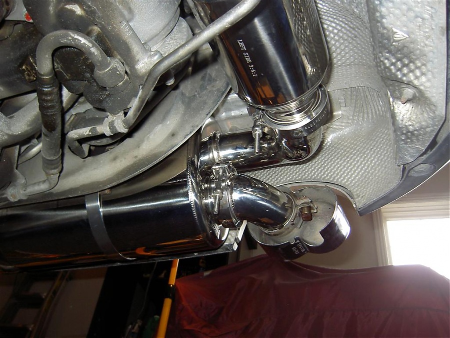

Had a couple of hours last night, so I pulled the current exhaust and cats. My plan was to set the new system in place this evening. I was going to replace the copper nuts holding the cats on the turbos, but I called every hardware and parts store around Detroit this afternoon and couldn't find any copper nuts. The ones that came off looked like they came off okay, so I going to try and use them again.
My biggest problem, though, was getting the O2 sensors out of the old cats. I ended up bolting the cat to my work bench so I could get some leverage on it.

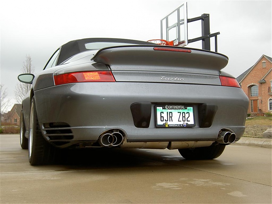

Well,, the FS Gen 3 is installed with the exception of the tips. Went to put a tip on to check the alignment and found my dual-style Eisenmanns are about an 1/8" in diameter too big for my muffler exit pipe. Argh!!
Old Apr 12, 2008 | 08:52 AM
jt2's Avatar
jt2
Joined: Oct 2007
Posts: 161
From: SF Bay Area
jt2 is infamous around these parts
^^ I had the same exact problem: Eisenmann tips that fit the factory exhaust were too large when installing a Fabspeed exhaust.
I made a sleeve using strips of sheet metal, and it worked like a charm. I'm not sure what it is called, but it is sold in a roll, such as is used to strap a hot water heater into place. Any hardware store should have it.
Old Apr 12, 2008 | 11:04 AM
Flyfisher's Avatar
Joined: Mar 2008
Posts: 129
From: MI
Flyfisher is infamous around these parts
Yeah!
Thanks jt2. I had to run a few errands this morning, so I stopped by Pep Boys and they had these nice compressible sleeves that worked perfectly. So when I got home, I buttoned everything up and fired up the car.
Sweet sound! I got this sort of gurgling sound when the car was at idle. Hope it isn't just a new muffler and cat thing, because it sounds great! Getting the car out on the road, I found all the droning gone. The exhaust is so much quieter from the cabin. Exactly what I was looking for. I think it is a little quieter as well from the outside, but it still has a great, wanting-to-be-heard sound. I think I am really going to like it.
