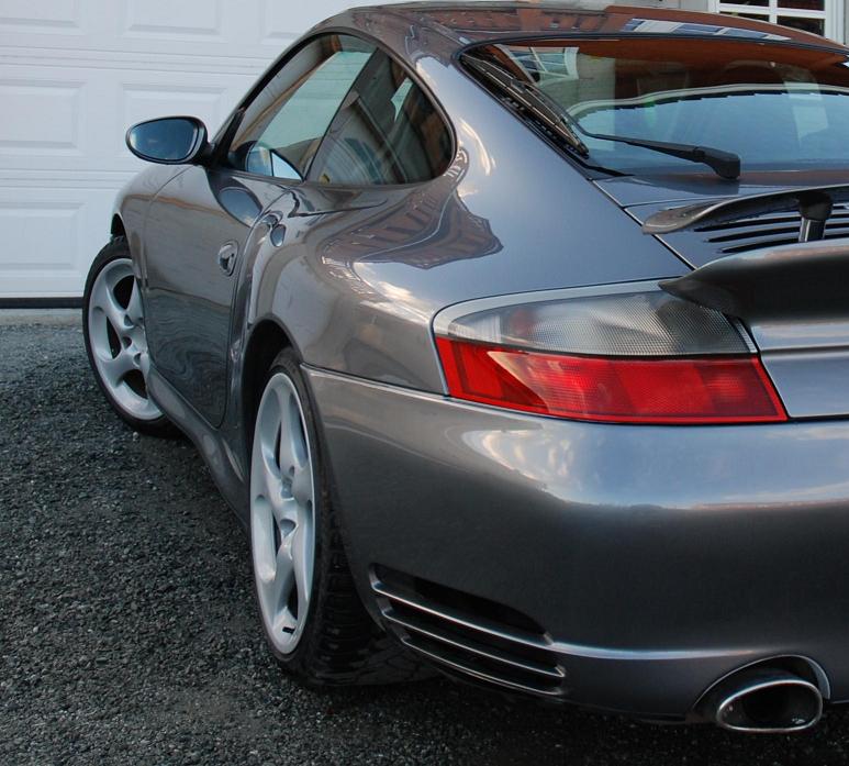

Here is a picture of my car with 265 width Dunlop M3 winter tires on 11" stock wheels. Doesn't look too good, but worked very well in snow and ice, with no issues.
Not everybody recommends this combination!

i dunno if this helps at all, but here's mine (not the greatest picture)
265 + 11.5" rear

The both look fine to me - I guess not idea but looks like a good solution given it is free (vs buying a new set of wheels)...
