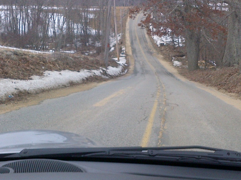

take this for what its worth.. ive had to drive these roads to get goat milk. yr round. snow.
it snowed almost every week this winter in boston. all i had was dunlop winter tires. abs and psm wasnt working. never had an issue. the weight on the rear axle , with all the weight right sitting on those winter tires makes these cars handle better than most awd vehicles on the market TODAY.
check these roads out. these pics are from the beginning of april.. picture how it was in feb/march... rwd works
