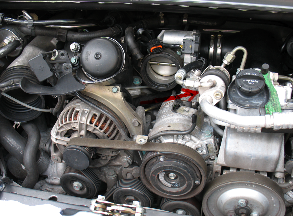

I just added a picture with the location of the fuel cooler....

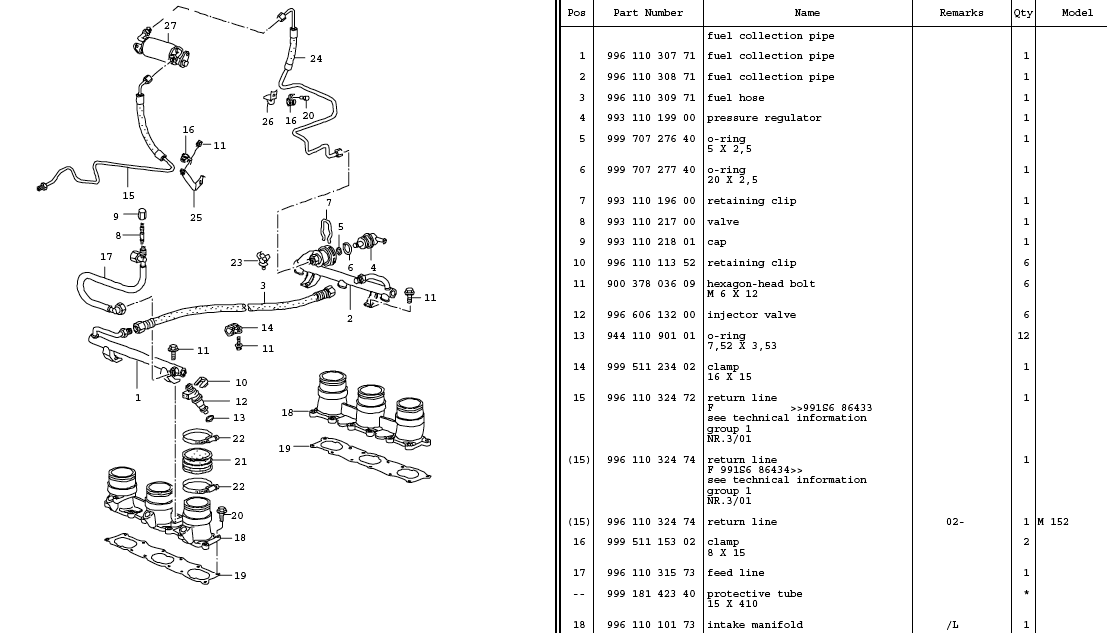

Just look in the parts cat. and the cooler (27) is in line with the fuel return line # 24 and #15....
