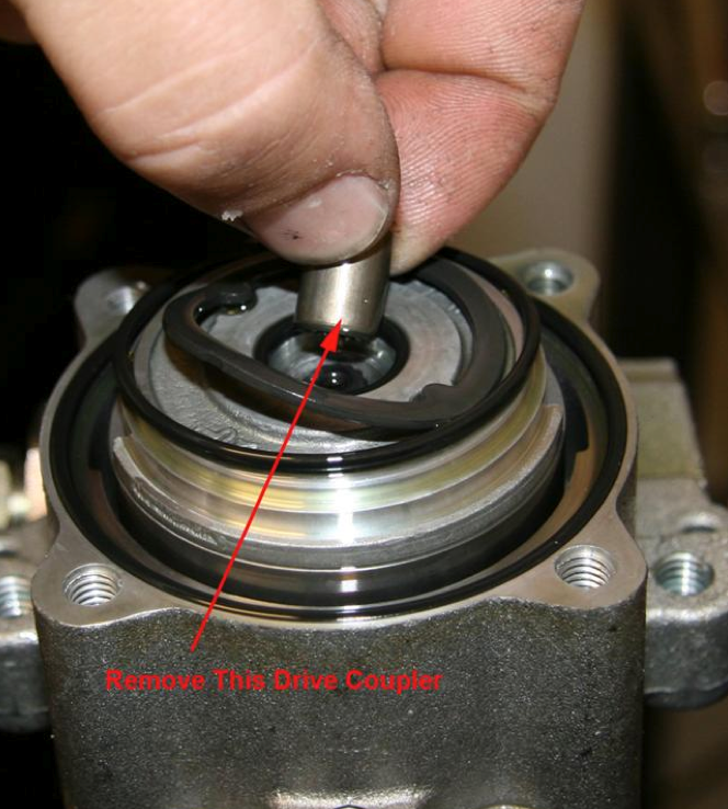

My clutch pedal is so soft when i press it and when i hit it to the end its not fully disengagement !!
From the most what i read here it looks the clutch Slave cylinder failure so .. i think i have to upgrade to GT2 master/slave cylinder conversion its my excuse now .
But some of u guys mention that i have to upgrade the PS pump. I wonder why i have to ?
What do u think guys ? any suggestions ?

The upgrade of the steering pump is part of the GT2 conversion. You need to remove the drive coupler inside the steering pump which is not in use anymore....

so u need to buy a new gt2 P/S pump ?! the upgrade is only removing the drive coupler !!?

No no you just need to remove the coupler... You are not using steering pump pressure anymore and removing the coupler eliminate this function.

Thank u alot jpflip that was very helpful rep points for u
