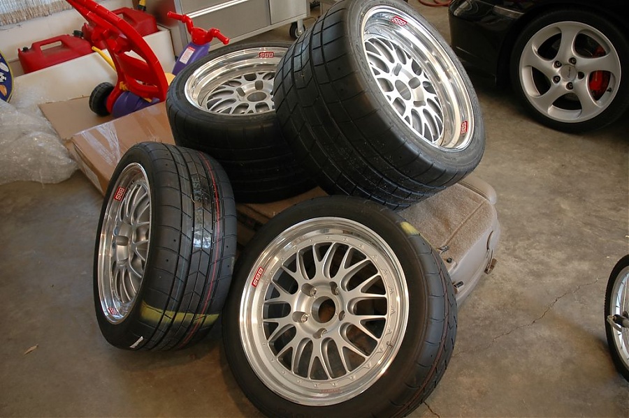

Originally Posted by alex55
Bbs Lm !
PICS!!
Please add pictures of the wheels on the car while making suggestions (soley for my viewing pleasure...)

Originally Posted by ///M_Chap
PICS!!
http://www.6speedonline.com/forums/a...lms-tires.html
