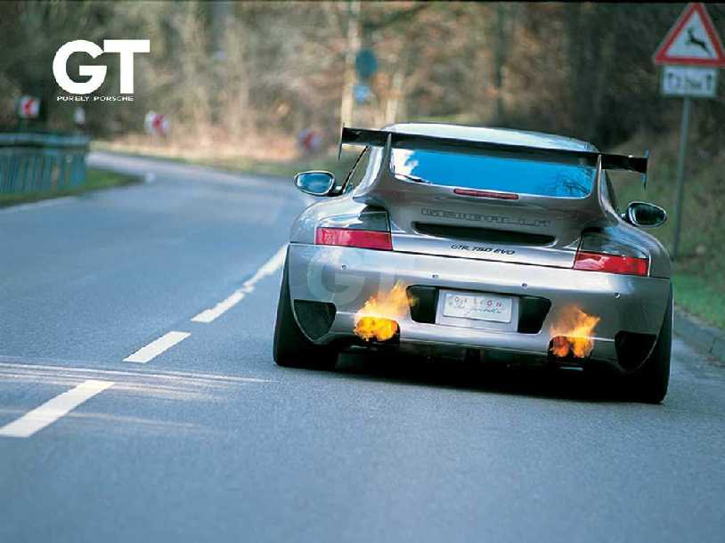

Originally posted by wilber
I think that car is all show no go.

The problem with the Gemballa GTR750 Evo is that it's not really a streetable package. If I wanted to run the Nurburgring as fast as possible for one day, I would setup my car differently. I'll bet you anything that the GTR750 motor will not even last 10,000 miles under hard use. It is a one-off car that was designed to showcase Gemballa's products, even though they don't do any of their own tuning. Before it was Lotec engineering who did their ****ty setups, and now its TTP.

- Gemballa EVO750? The Gemballa 650 is the one I'm talking about, that the one that sets the records.

FYI, the current record holder is the Gemball GTR750EVO, the previous record holder was the GTR600. But remember that before them, the Roock 580R held the record. And we all know what a great tuner Roock is, right? The problem for US tuners is one of logistics. I wish the US guys would ship their cars to Germany for the Tuner Grand Prix, but it really is a hassle, especially if something should break or need last minute readjustment.
