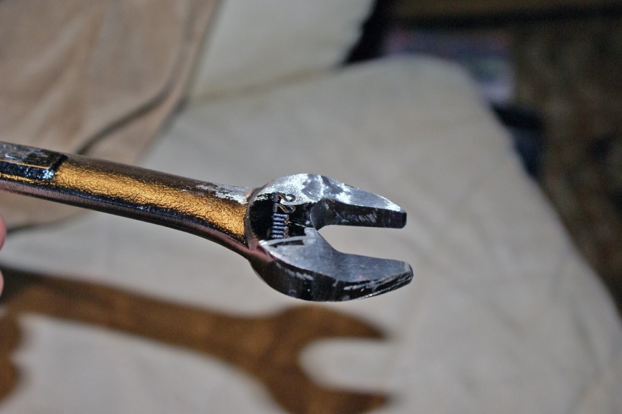

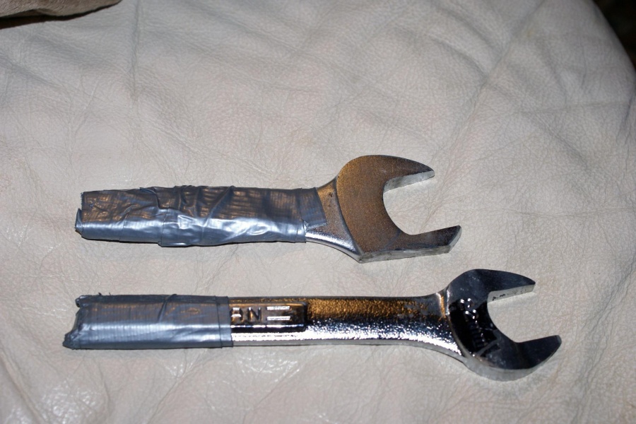

Wow ! What can I say, what a cumbersome task. Fortunately it was only the accumulator and not the pump.
Swapping the item itself takes like 5 minutes. That's the good news. I spent a couple of hours shopping for and custumizing the right tools.
My problem was that the accumulator that was on the car needed a size 22 wrench (a 996 part), where the one I had to exchange it with was a size 27 (they will now send you the 997 part when you order the item). As a result, I had to cut down 2 large wrenches and then grind down the head of the wrench so it can be used in the confined space where the action takes place.
I am still wondering why Porsche designed and placed the accumulator this way ???? Must be to draw some traffic to their maintenance departments.
Glad I did it though. Should only take one hour next time around :-)
