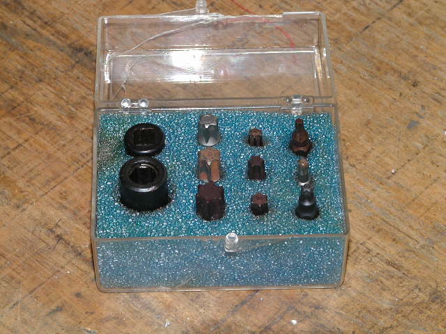

Spoiler motor set screw - pictures
I've had a couple of people PM regarding the spoiler motor fix I described above. Here are some instructions with pictures. It's easier than I remember, probably because this time I knew what I was doing.
Tools needed are: 10 mm socket and star drivers as shown in picture 1 below.
