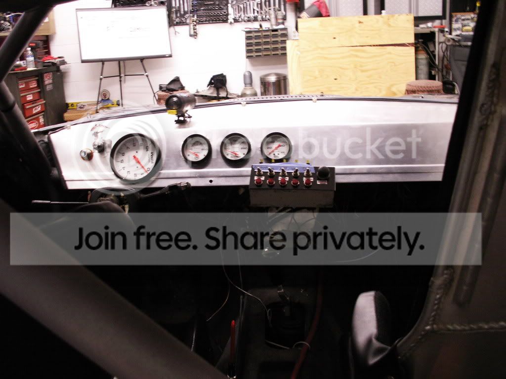

Spent the weekend working on the track car...
...And except for a fuel pump issue, we'd have had it running this weekend, pretty sure...
New pics:
Getting there!
Mike

Better shot of the dash...

What are the specs on the motor/trans?

It's a bowtie four bolt main block that's been screened and prepped to roadrace standards. The rods are 6 inch eagle H-beam forged units, with a scat9000 crank, and Wiesco forged pistons. It has ARP studs and bolts everywhere (except the waterpump pulley... lost them!). The heads are Dart Conquest 2.05/1.6 valves, running an isky hydraulic roller cam with 282/294 duration with a 530/550 lift. I'm running an Edlebrock Victor Jr. singleplane intake and a Holley 750DP mechanical carb. The ignition is full MSD, 6AL/Billet distributor/coil.
I'm runnig a roadrace oilpan with trapdoors and crank scraper, along with windage tray. I'm also using a Canton accusump, oil filter system, and Mocal oil cooler. The engine builder claimed 530Crank HP, But I'll be happy with 400WHP in this 2200# rocket!
Tranny is a Tremec TKO600 (with roadrace gearing) with a McLeod Blow Proof bellhousing, and I've got a 153ring LWFW, along with a custom Tilton hydraulic release bearing. I'm using a Centerforce clutch/PP for the moment. We'll see how it holds up. The driveshaft is only 19inches plus yoke and flange. The Rear diff is out of an infinity Q45 and has LSD and a 3.54 ring gear. I'm using custom cv axles rated at 750#ft. torque...
This build has been an 8 year on and off process... I'll be glad when I can finally use the car... I've done 90% of the work myself. I only paid for the paint and for a change, paid someone else to weld in the cage (I've built a number of my own over the years).
