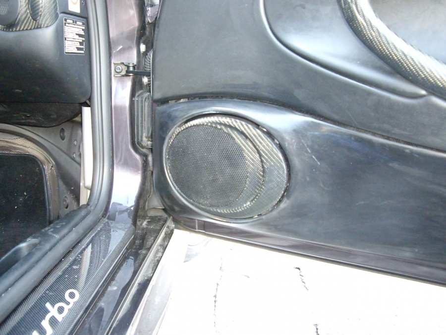

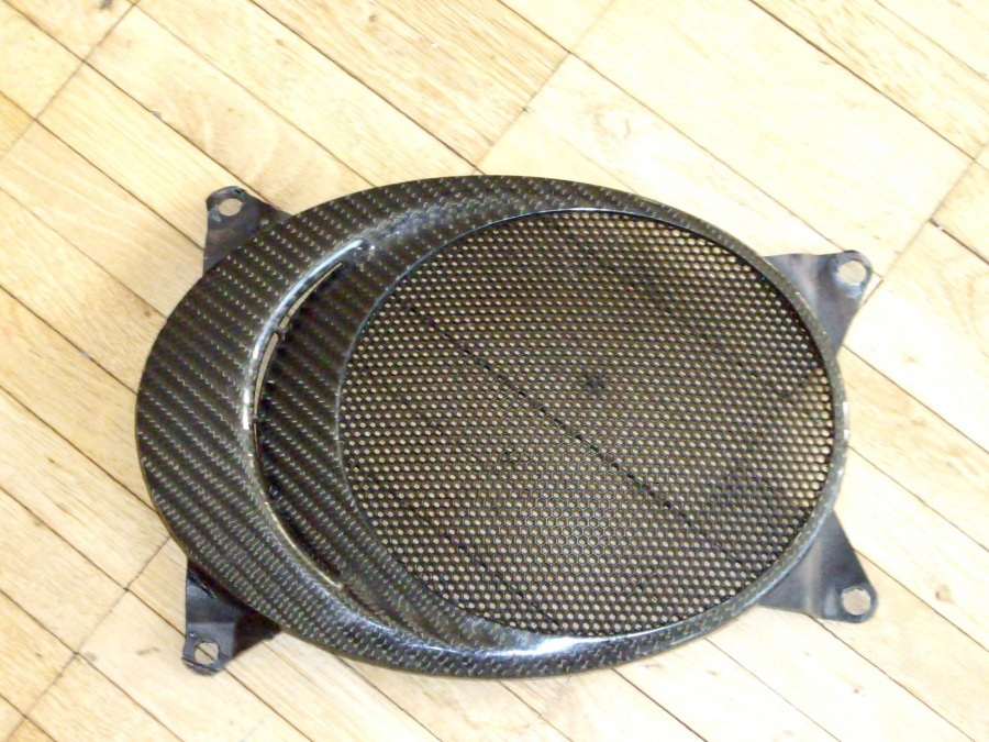

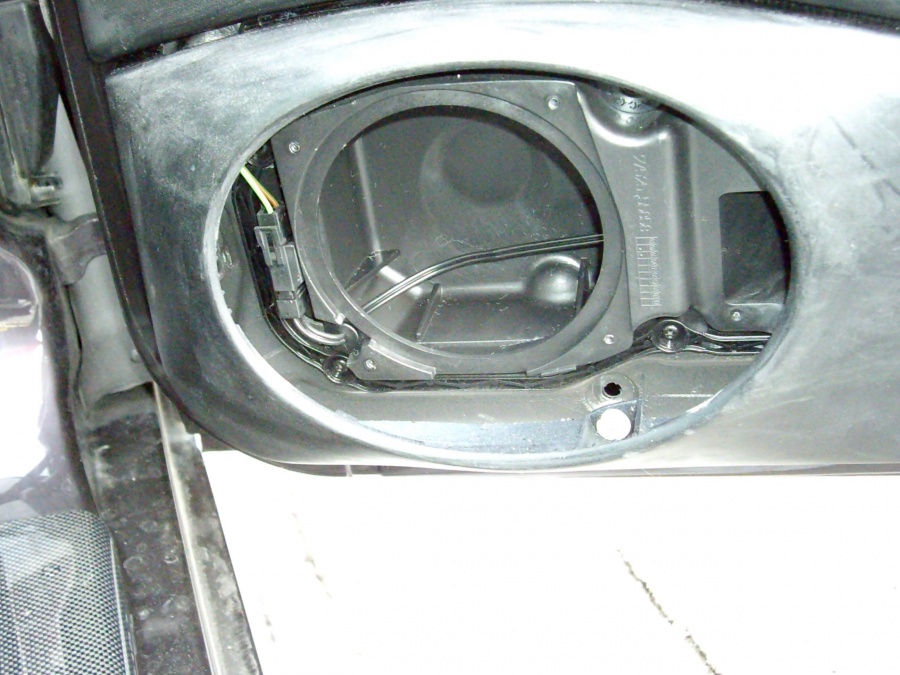

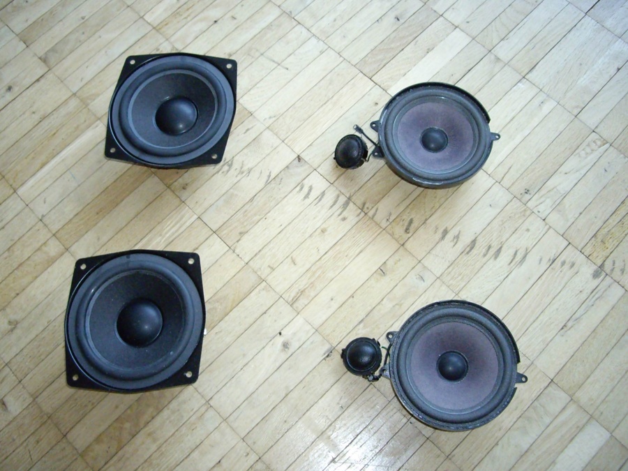

Ok that was actually easier and more fun than I thought
1. Physically pull out the bottom of the door panel ( push on clips )
2. At each corner push in the speaker cover into the door panel
3. Drop down the speaker cover under the door panel and take it out
4. Simply unscrew the speakers
5. Reassemble
The door speakers are the heaviest about 3lbs each and I also took out the front speakers from under the windscreen and left the covers in place too. All in all about another 10lbs out.
