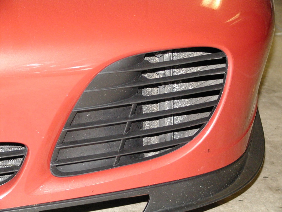

On my car ('01 TT) there are no holes in the bumper itself. Only in the grill. See picture below. When the bumperettes are installed, the solid upper corner of the grill is cut out. The grills have to be inserted from the rear with the bumper off.
Jon

there is holes in the bumper
Jon
Ah nice, so I need to order a set of 02+ bumper grilles then and i'll be good to go you think?

i did 1 a few months ago and there was holes in the bumper itself
