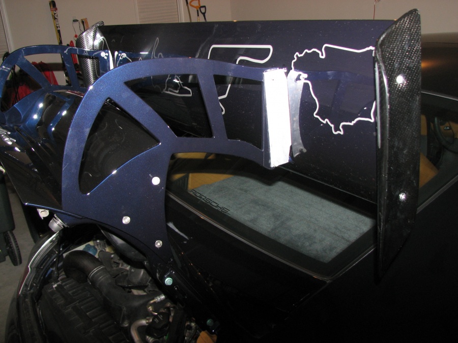

Just did the wing. All in midnight blue. Wow. Wow. You can really feel it too.

Old Feb 21, 2009 | 11:01 PM
  #60
SamboTT@ByDesign's Avatar
Joined: Sep 2003
Posts: 4,901
From: L.A.
Hey Jeff,
Looks awesome. Nice to see that it worked out but really glad for you that you are enjoying it and can feel the effect. It's like liquid-courage but I call it aero-courage.
Be safe.
Hey John did you call Dave?
See ya guys.
