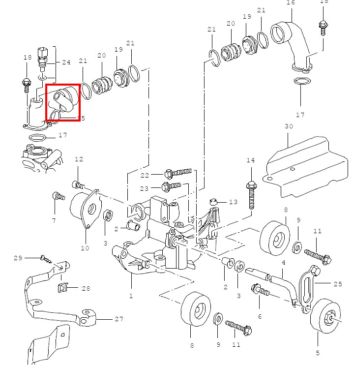

Finally got the car fixed. Turns out the leak was because a press fit connection blew out. The picture below shows what it was. Nice to be able to drive the car after 2 months without it. Driving the Mini is just not the same.

I just had my second failure of this part. The first fitting lasted 6 years and about 80,000 miles before letting go. It was replaced last year with a brand new OEM part and I thought I would be good for a long while. Last week, less than a year after installation, the new part blew a fitting out again. The part only was under warranty, but the cost of removing the part was way more than the repair. Fortunately, it was the side towards the drivers side and we could access it by removing the alternator. My shop did the epoxy repair for under $500.00 and we devised a bracket to prevent it from popping off again. The other side is still at risk and more difficult to access. If I knew last year, what I know now about this part, I would have welded the two aluminum fittings to the body of the part before installing the new part last year. If anyone is having to replace this part, I strongly suggest you weld the two fittings in place, which would prevent a likely second failure at some time in the future. This part is of weak/poor design and should have come welded instead of epoxied from the factory. Even a tack weld with the epoxy used would probably last forever. Amazingly, the car was in at 11AM one day and ready for pickup at 10AM the following day.

John, do you have any pics of this bracket you came up with? My engine is apart now and would like to do all the preventative stuff while it is out. The shop told me that this same part looked like it was about to go.

Don,
I don't have a picture of the bracket they made and the bracket is not the best way to deal with this - we did it because it was the side we could reach without removing the engine (this time) and we just epoxied again. With the engine out and apart, remove the oil cooler and weld the two pipes to it. They are just epoxied in place and the epoxy breaks down. Many will have this failure as they accumulate years and miles. I had a new OEM part fail in less than 1 year. Here is a picture of the part, you can see the pipe on the far side - the near side is the one that popped out the first time and as you can see it's not there. I was still connected to the hose. Weld 360 degrees around the base of the inlet and outlet pipes where they enter the housing and you won't have to worry about it ever happening...that's what I should have done the first time (just permanently repaired the part, live and learn).
