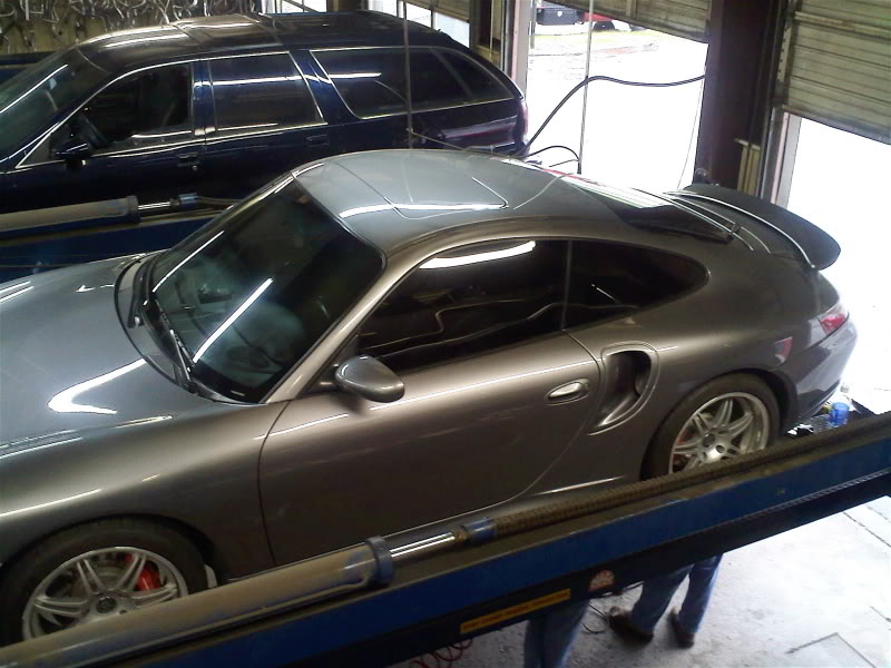

Here are a bunch of pics from start to finish.

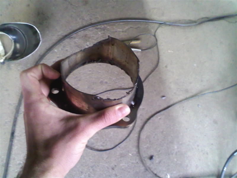

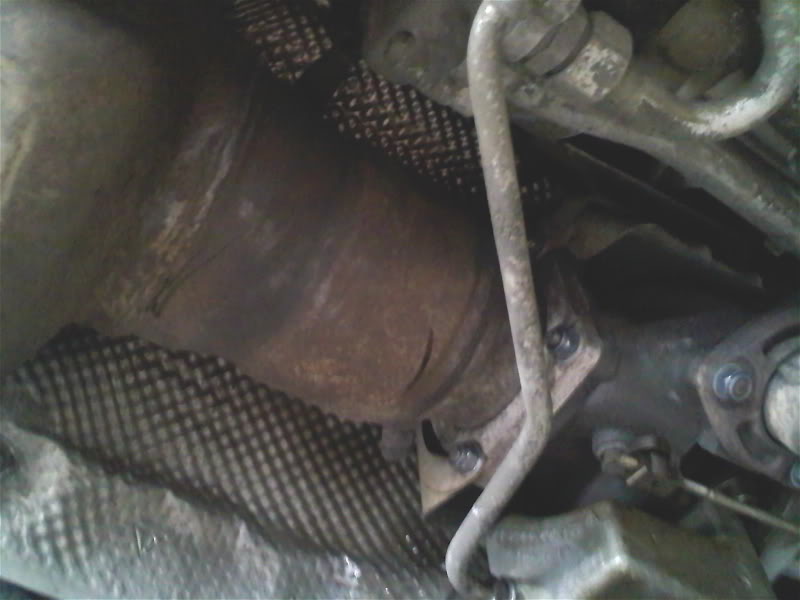

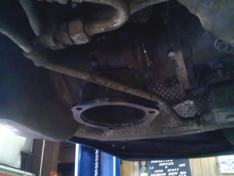

Marking the area to be cutout of the catalytic converter:

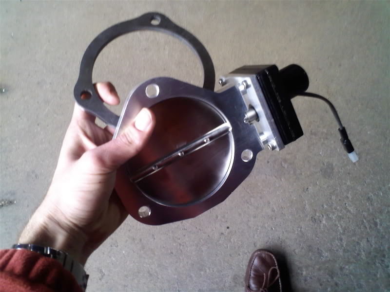

DMH 4" cut out (3 year warranty, great product btw, i've had them before) with flange included

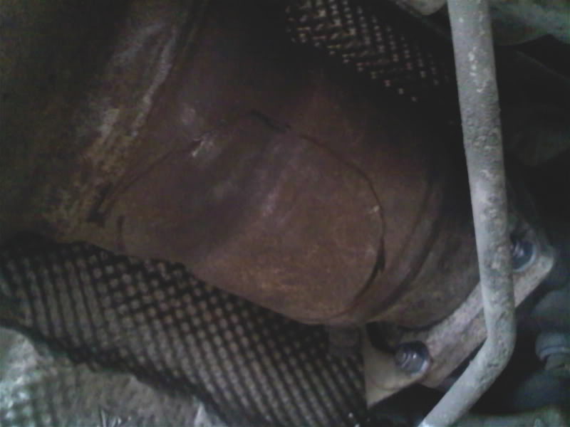

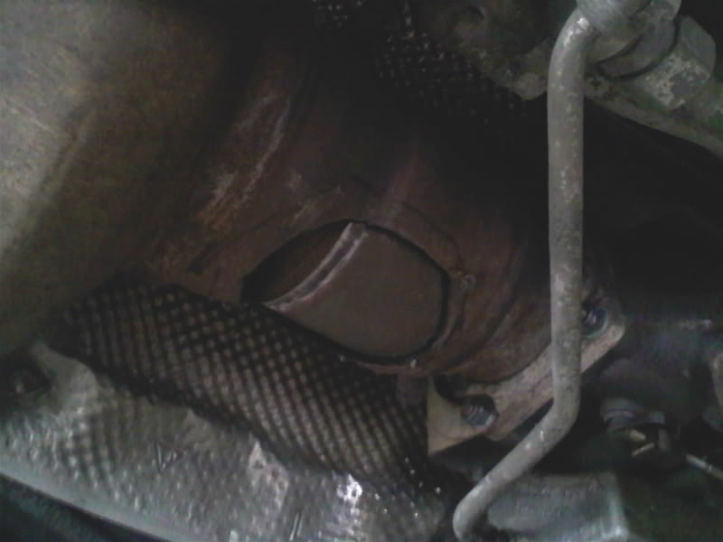

Cat opened up, you can see where it needs to be gutted

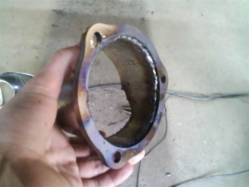

Flange welded to tube:

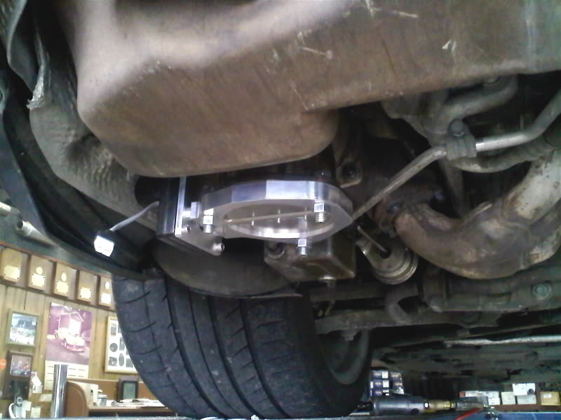

Installed on cat

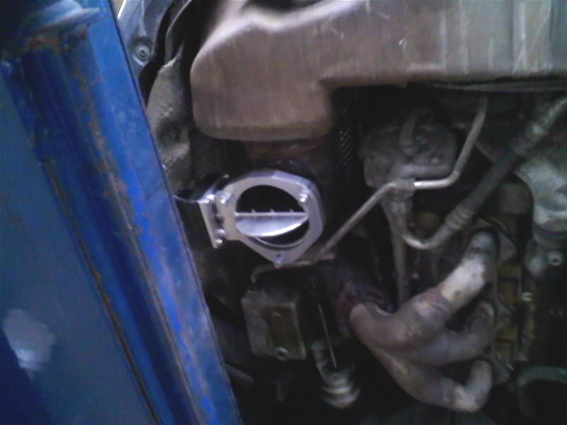

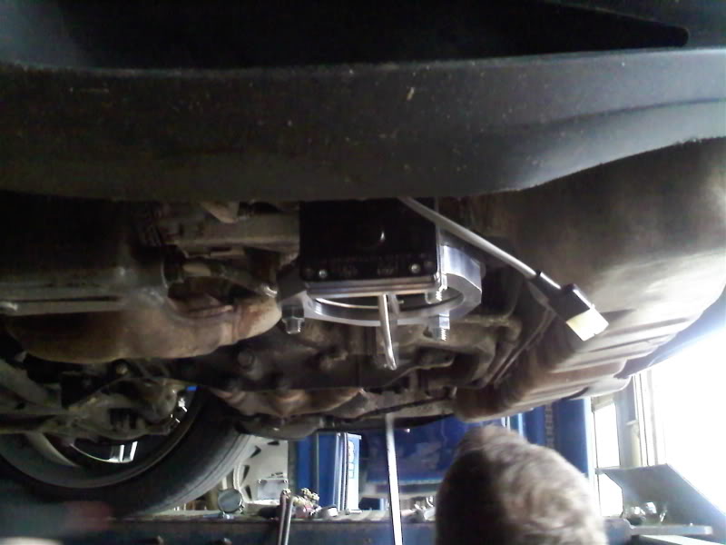

cutout bolted up to check for fitment:

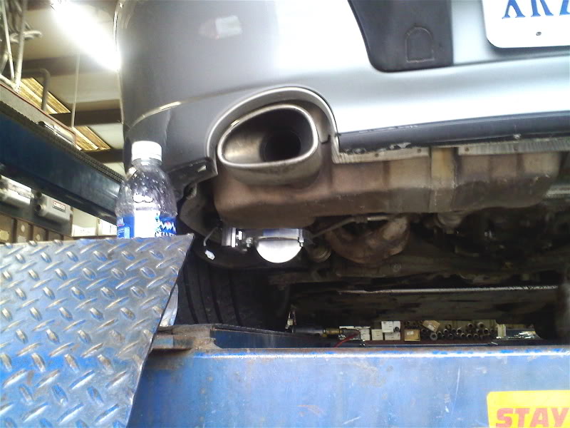

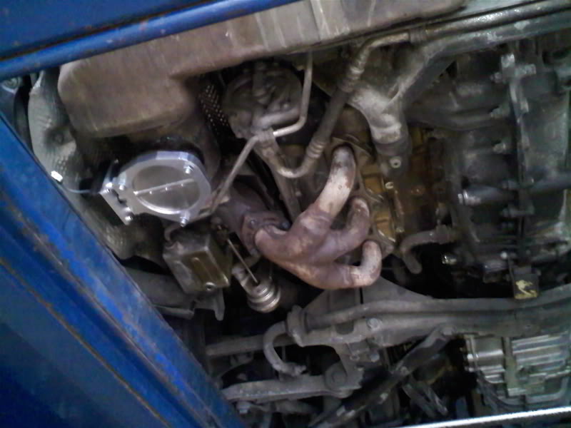

"open"

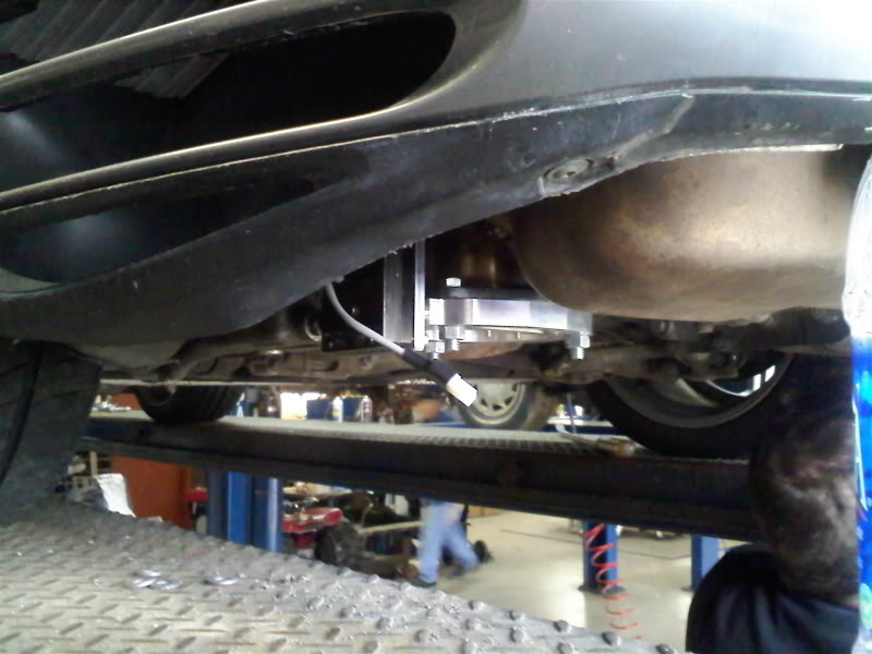

Closed

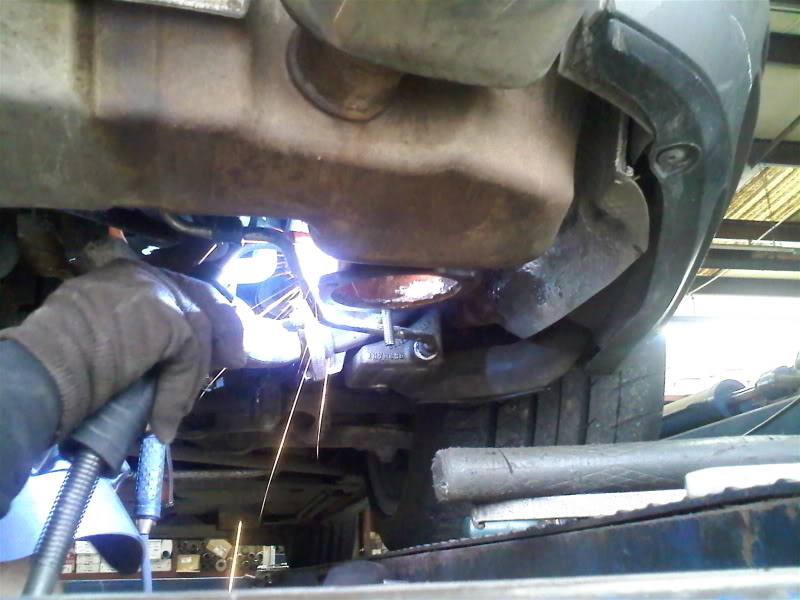

passenger side being fabricated

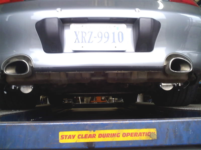

They look like they hang lower than the muffler but when you're eye-level with them you can see that they're exactly the same height and they don't stick down below where they could get hit

Man I hate to be the worrysome type, but in the future I would NEVER weld on something with it on the car, unless you remove the battery. Even then, the exhaust is an easy removal... Good chance of frying electrical components, seriously...

I got the cutouts from DMH. Battery was unhooked just in case heh
