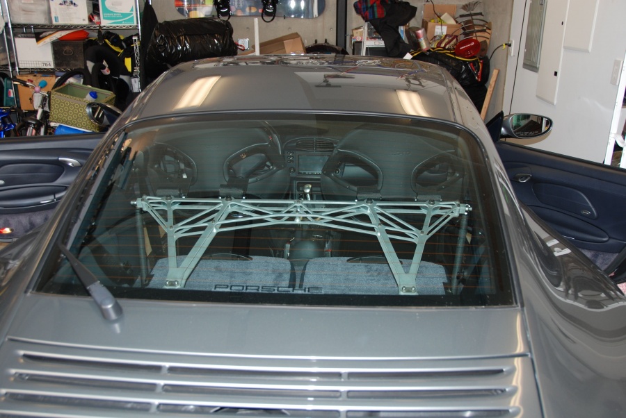

This BK harness is the easiest to remove
R1035 Truss Style Harness Mount was developed in response to customer requests for a truss-style harness mount for the Porsche 996 coupe. Like all Brey-Krause harness mounts, the R-1035 uses only existing mounting points. No drilling, welding or fabrication is required for installation. Once installed, the main portion can be unbolted in ten minutes, allowing use of the rear seats.
Installation: Bar attaches to rear strut tops & seat belt mounting points and is easy to remove/reinstall.

I've used that B-K harness bar - great setup. Fairly quick to remove, and easy to install. Works well for my DD with two car seats...
I may be going the dedicated track car route soon if someone is interested in it.
