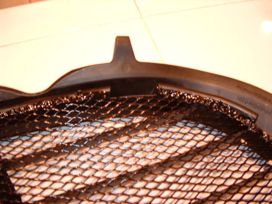

Here's a link to the grill screen installation DIY I recently posted:
https://www.6speedonline.com/forums/...eens-pics.html
My first question are why did you use screen that is so large? If your objective is really to keep crap out, then you should have used the small, black, powdercoated diamond mesh from the same vendor. See the pics in my link above and note that even small butterflys are kept out. Secondly, why mount the mesh so that the diamond patern is vertical? It doesn't match the lines of the plastic grill nor the shape of the front of the car. Lastly, I understand you zip-tied the center grill to the rubber boot in front of the radiator. Now you won't be able to get to your radiator easily (even when you remove your bumper to clean the crap out--w/ vaccuum or whatever) that will come through your large screen. I guess you will have to cut the zip-ties, remove the screen and then reinstall.
I am being very critical here only because I've recently done a lot of thinking on this subject and designed and installed what seems so far, to be a great solution. I drove 175 miles yesterday in 85-90 degree heat with no temp problems (and you should see all the crap my small screens kept out of my radiators).
Any thoughts on a comparison appreciated.

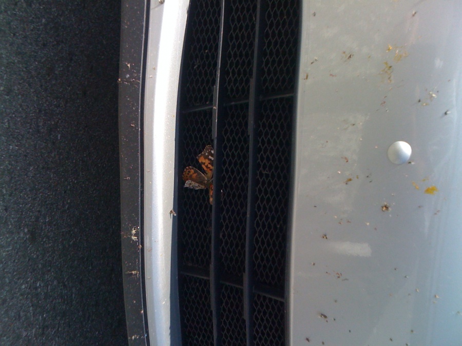

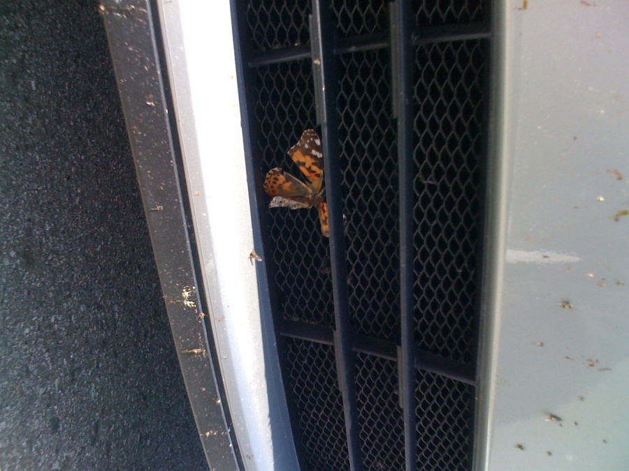

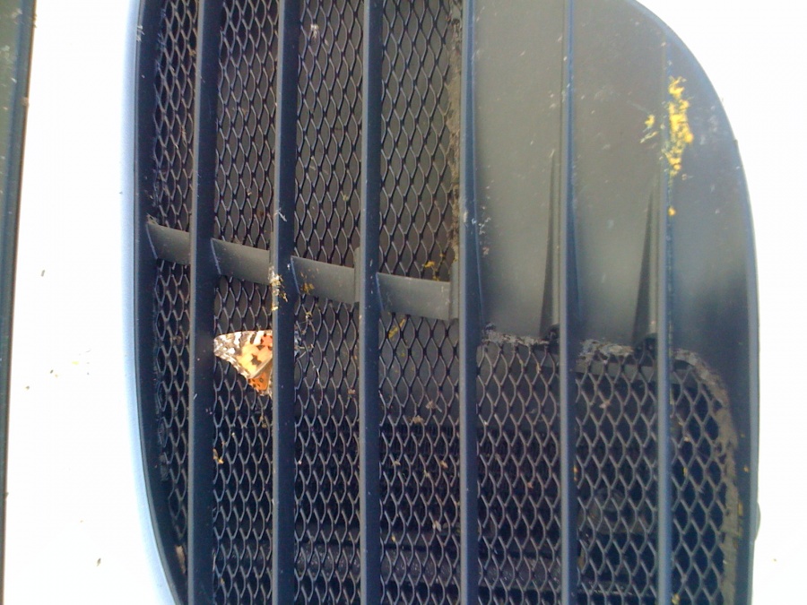

Small grill screen bug pics

I used permatex around almost the entire inside perimeter of all the plastic grills. How it could come loose and vibrate I have no idea, but opinions welcome.

Somebody recently posted a GT3 DIY on Grill Screens and commemted that they got the XXL size for Cust Car Grills and thought it was too big. Just a preference thing. One of the reasons I went with small is that you said you had no problems w/ your previous mesh size that was rather small and that I had asked you about some time ago.
With my permatex process I'll grant you that you have to be very careful and the screen mesh must fit PERFECTLY, i.e., cut from a template.
