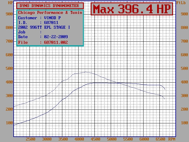

Again, very interesting conversation. I don't know much about the relationship between tq and boost; but I do get a pretty good kick when the car spools up and there is pretty much no lag. I know different tuners tune the P-car with with their own philosophy; maybe that's how EVOMs tunes their GT660 package.
Here's the boost chart... please comment...

Okay i will honest here as well...that TQ is very very low. Something must be wrong. All i can say is my k16 car with EPL flash only (no other mods) produced 400 HP ,480 Tq on a dynodynamics 70F day. My k16/16G car made 540TQ on a 70F day on dynodynamics.
I thought that might have been limited by tuning to save the transmission.
Dynodynamics usually reads about 5% lower than mustang.
Those are stong HP numbers, but with the TQ fixed...you will feel your car to be much much faster. The overall fun factor increases.
Also a TQ convertor might increase your safety margin , especially after seeing a TIP failure(blackhorseturbo), i see that as a smart move.
Thanks vbmw335, my question is does it actually go faster or just FEEL faster. My car drives very much like a NA car with a better kick. And throttling is very easy to control.
Yes it will feel way faster and will go faster. Also your TQ starts peaking late...mine with 16g's hit peak around 4500. So yes overall faster and will be a big difference for sure. GT28's are supposed to spool fast and carry power longer as well. I wont speak much about tuning details ...since i am not that good with that stuff...leave the why's and how's to ttboost,blkmgk. All i wanted to do was flag my observations which might help you get some more out of your car safely.
I attached my car dyno on just a k16 Flash no exhaust for your reference. I can also send you a 16g dyno sheet where it made 540TQ with no exhaust.
