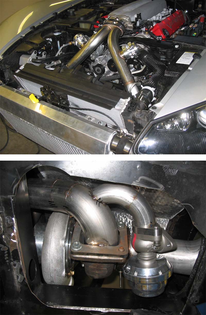

**Update**
Motor is back in, pipes still need to be polished, and two Blow Off Valves are in place.... Not sure what i'm looking at in the lower picture

Isn't the two things on the top pic from the two pipes the BOV? What the heck do I know.

looks like great craftsmanship
is that turbo resting against the frame?
also, while the turbo is in a well circulated place, it's still gonna generate a lot of heat, will that cause a problem for the BOV right next to it?

Wastegates shank, atleast I believe so
I believe that's a Tial BOV on the bottom pic specifically

Shank, I expected a little better craftsmanship. Hope it workes out and lasts.

Are you guys ****ing kidding me? Thats a tial WASTEGATE, not a BOV. I hope all of you are being sarcastic, i would think with this class of cars simple things like that are common sense. Wastegates control boost, bov's release air when throttle plate closes to prevent turbo surge.

Guys...
That being the exhaust side of the turbo, it would have to be the wastegate. That much heat would roast a BOV pretty quick. BOV's go on the intake side usually between the intercooler and the throttlebody.
Looks very good to me, everything is tig welded and is SS. Its just a mock up, finishing welds and polishing will come later.

Originally posted by Sloth
Guys...
that's what I was thinking, I had a momentary brain fart
