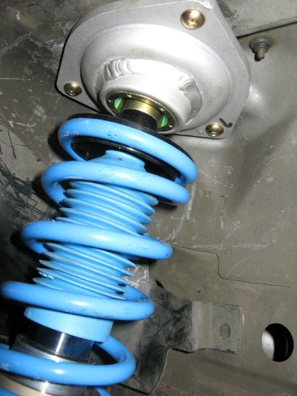

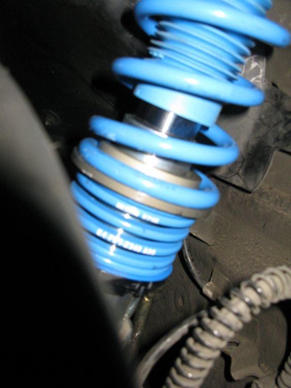

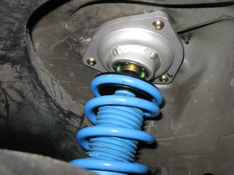

Can you post pic of the shock assembly. The lowering height should not be affected.
Will see if my man JJBravo can comment.

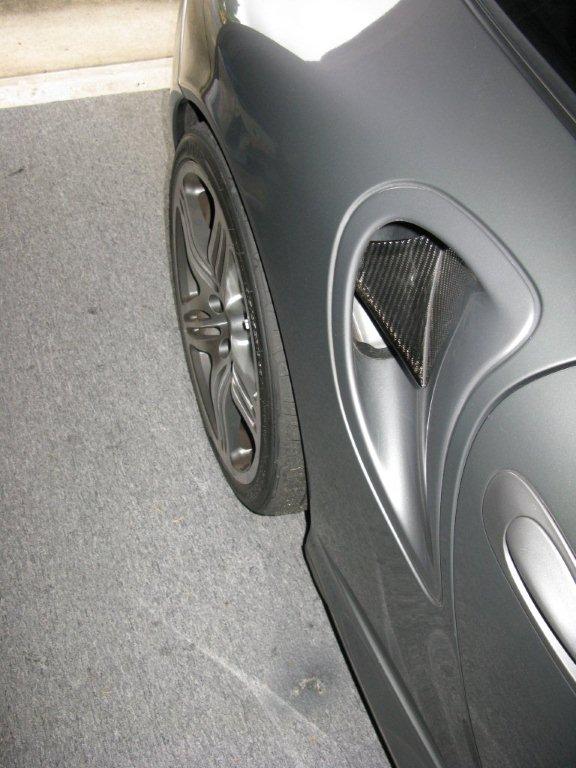

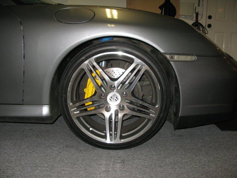

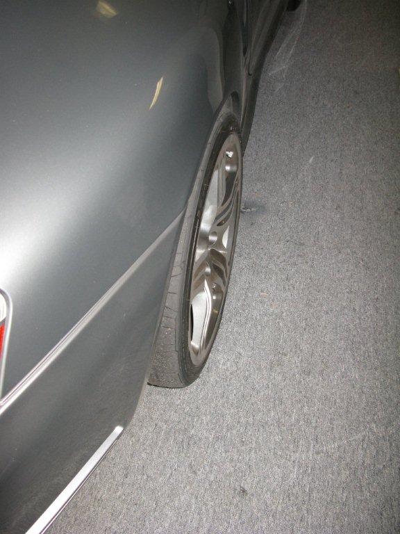

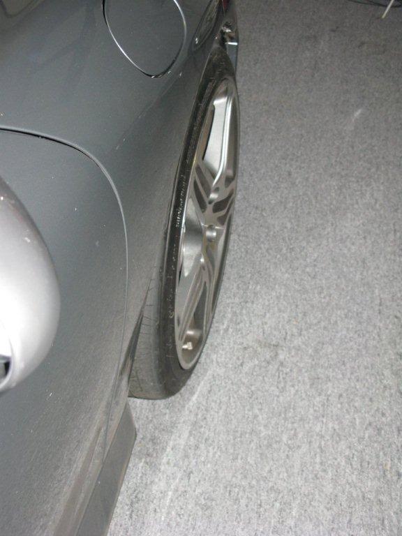

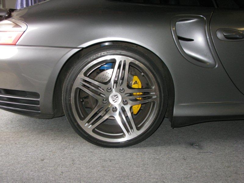

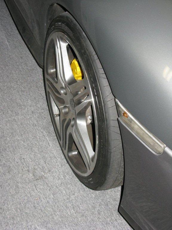

19" NITTO invo's
1' spacers all the way around
26" at front (hoping to go to 25.5")
25.5" at rear (need to roll fenders)
springs are unloaded (on a jack to take pics)
Old May 31, 2010 | 11:26 AM
LO_996tt's Avatar
Joined: Mar 2010
Posts: 112
From: USA
LO_996tt is infamous around these parts
PICS: Wheels are arches
BTW--saved myself $900 doing this myself thanks to the DIY's here. Still need alignment once I get ride height settled. I know I have too much camber in rear and not enough in front. Toe is also out in front from removing and spinning tie rod ends during install.
Struggled compressing springs (weird angles and clearance issues), but rest was straight forward--A lift would have saved me hours. Also found that removing wheel carrier and front cv like JJBravo saved time and energy on the second front side replacement. Extra couple of bolts was all it took and saved my sanity.

Mode camber plates have a built in -1 degree. You then use the factory top sliding adjustments for more or less camber.
From the pics, it looks like you can take the bottom spring color and adjust more from there?

spring color?
You mean take the bottom spring collar out? What about a shorter tender spring?
Does adding a spacer doing anything to camber? My sense is no, but not sure?
