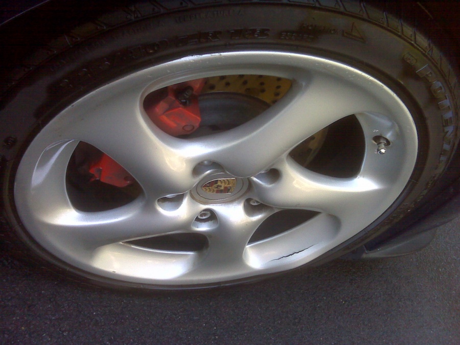

I have a 2003 TT Lapis Blue with almost 30,000 miles and OEM wheels and tires (Bridgestone Potenza S-02A). The front tires have lots of tread and the rears have to be replaced soon.
This morning while washing the car, I saw this (see attached photos). No idea how this happened, I did take a long road trip recently. I guess I drove over a curb, but I can't remember hearing anything. I can't imagine this just occurs from normal highway driving.
The other wheels are in typical 30,000 shape with small nicks and scratches, but nothing like the front right wheel.
Appreciate your thoughts and suggestions:
should I
1) fix the wheel? is it safe to drive as is?
2) replace OEM wheel and order two new rear tires from Damon at Tirerack?
3) take the plunge, get all new wheels (better price/quality/look?) with a reasonable budget
Looking for the right long term fix. Thanks again.
--BM

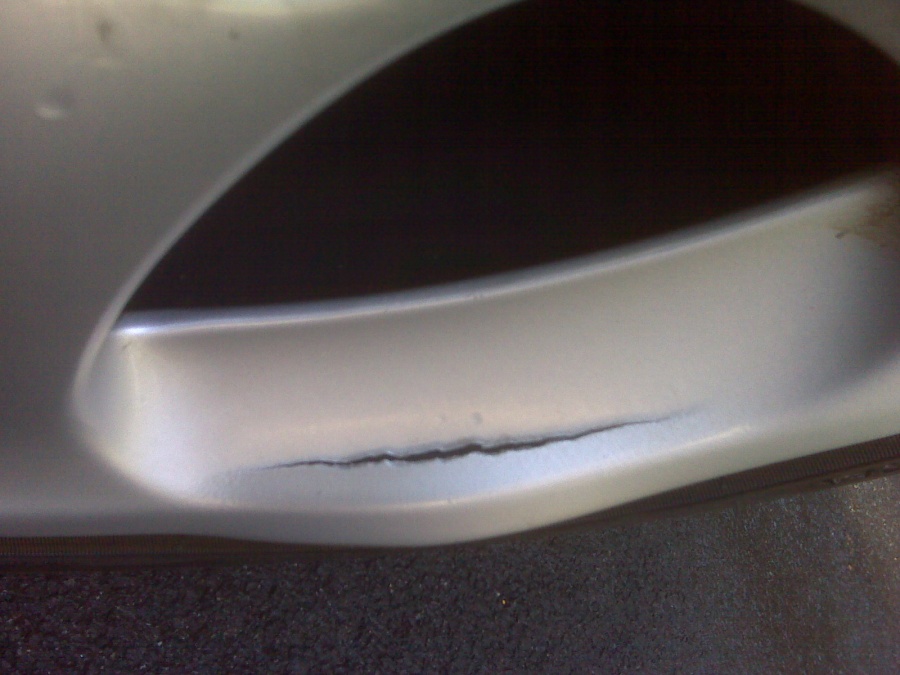

1, Wheel is scrap. It is NOT SAFE to drive. (I suspect there are shops that might fix it- ie strip, rework, weld, re-true, re-fnish- but not for me, They claim when the damage is contained on the barrel it can be repaired.)
2. Unless you are buying wheels at the same level of QUALITY as factory (ie $3500 up for wheels alone) then just replace the rear.
It is astonishing that you didn't feel this. It had to be a very significant impact- a big pothole, large chuck of debris....
GL

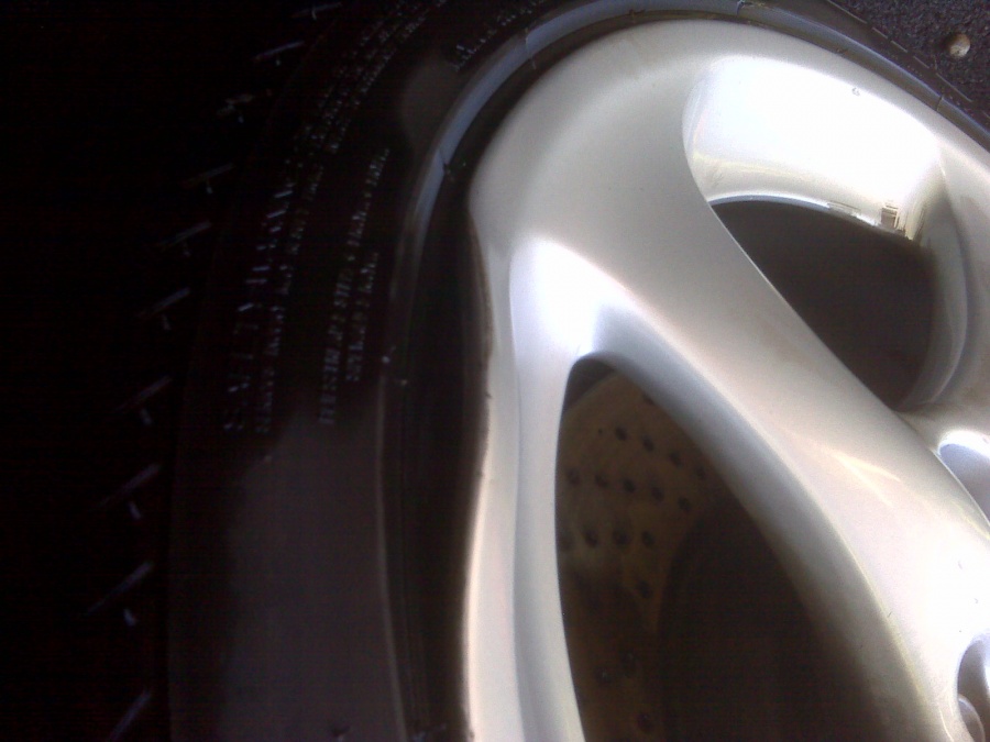

That wheel cannot be repaired safely- you need to purchase a new wheel. With that much impact force, I'd also recommend replacing the tire- I'm sure the shoulder took significant damage at that location.
Keep a better eye out for curbs and potholes in the future!

+1 for Ard. These are cast wheels. They cannot be safely welded and refitted.
Also amazing you didn't feel that impact. Did you by chance have your car parked by a valet during the trip?
The least expensive solution is to replace the rear wheel and both rear tires. There should be lots of used OEM wheels on the market if you want to save a little money compared to a new one.

Wow I just put a huge chunk in my HRE last night and it isn't nearly as bad or large as yours, but there is no way you would not have felt me hitting the median/blvd! Sure you haven't been driving blacked out or in your sleep recently?
I would dump em and get a new/used set of aftermarket wheels. Some good deals in the parts for sale section here.

Wait a minute...how is that holding air???

Thank you all for your thoughts.....
The wheel with the crack is the front right wheel.
I was focusing on if I hit a curb, but after Ard's comments, I began thinking about, "did I hit any big potholes recently?", then I went, oh sh*t, yes, I did.
I hit a huge new pothole dead on at a healthy speed. I didn't see it because the car in front of me was blocking the view and swerved to miss it only at the last second. I remember thinking, oh boy, probably lost a tire, but the car has been driving totally fine since. The right front tire is in great shape and is holding air fine. I hate to replace it given it has so little wear.
I think I am going to look here and on ebay for a used OEM wheel front wheel (are left and right interchangeable?) and order the new tires from tirerack and have it all done together. If anyone is a seller of a used OEM front, pls PM me.
Thanks again.
--BM
