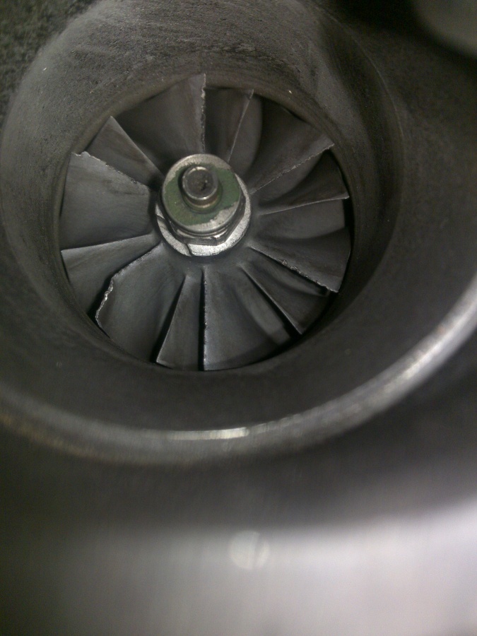

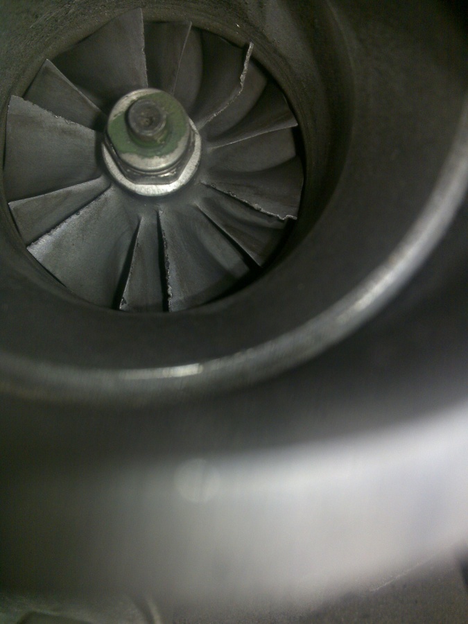

I was on the track yesterday and all of a sudden heard a whine sound from LR of the car under boost. Figured it to be a turbo and continued as I saw no smoke or check light. Finished the session and had a look this morning and what so you know, the intake hose popped off right next to the turbo in. On closer inspection it has sucked in some debris and bent the shaft. Unlucky or what? Not sure as to why it came off.

By the time I heard the whine I new the damage was done..the Whine is the result of a bent shaft spinning at 180k.

You're lucky you didn't blow the motor.
Air getting sucked in directly to the turbo avoids the MAF entirely and doesn't even register.

I was thinking the same thing. Just need to figure out why it came off before the new turbo's go on. I'm puzzled.
