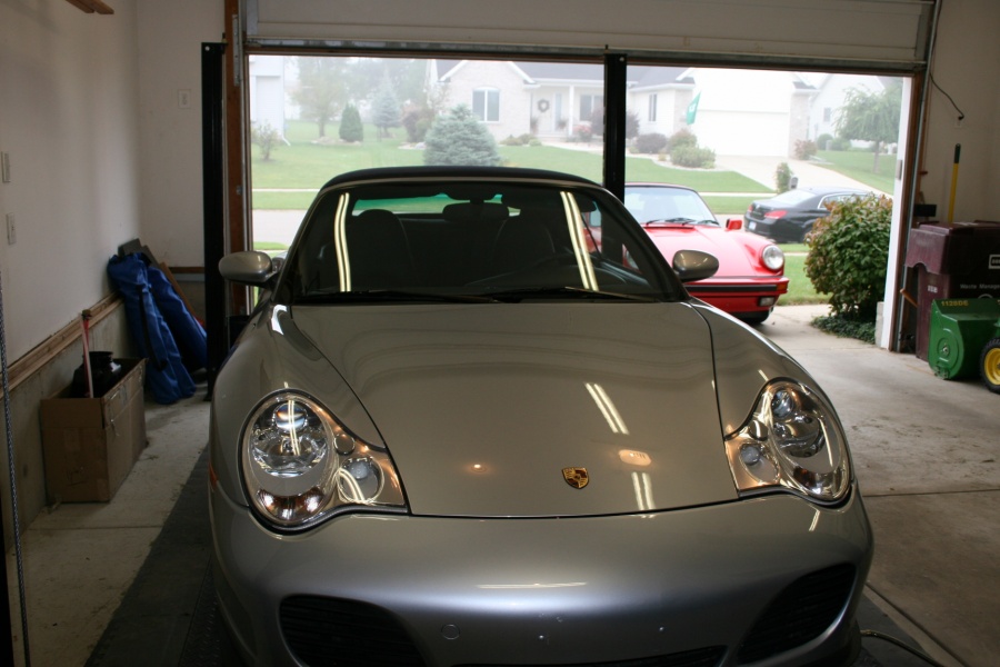

You're right, it can be tight in an 8 foot garage. Mine has 11 feet to the ceiling. My friend has an 8 foot ceiling and we put one in his. He can put his 930 up on it and still have a few inches to spare. It's tight but it works. With the pneumatic jacks and the variety of safety stops on the lift, he has been able to find safe levels to do everything he has wanted to do. Obviously, any type of SUV would be totally out of the question in his setup. Hope you find an acceptable solution. There's nothing like having your own lift. Even if all you're doing is polishing or waxing the car. Saves my back!!!

Here's the first 5 pics. Shows the side mount door opener and the re-routed tracks. A side benefit is the cleaner look of the garage without the opener hanging in the middle of the ceiling.

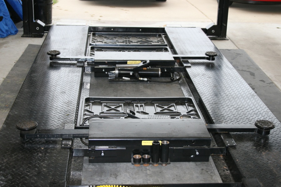

These three pics show the lift from the outside and the two "bridge jacks" with the arms extended fully and then fully retracted. Best thing I ever did. Made my 2 1/2 car garage into a 3 1/2 car garage.

True enough. I think I could take the tranny out with this lift. Certainly not a motor. I can do anything related to suspension etc. My other thinking when I got the 4 post lift was that I wanted to store two cars during the winter in Michigan. And, I did not want my four wheels hanging on the suspension for months at a time. I guess you have to really think about how you're going to use a lift when you're doing your research. It's rather hard to undo once you have the lift in the garage.
