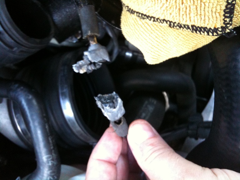

Fuse holder for my inline 044.... MMM toasty.
Can't believe I did not have a fire. The only thing I think it could be was the hot pole of the fuse was grounded to the y pipe. The wiring work looks really nice, taped fully wrapped and soldered on all connections.
This happened quite a while ago by the looks of it, and the lack of smell.
Brockway and fire extinguisher here I come!

I have the Brockway and the AEM air fuel gauge

Nice set up Dixie!! Can never be to safe! $150 vs 10000.00 +
