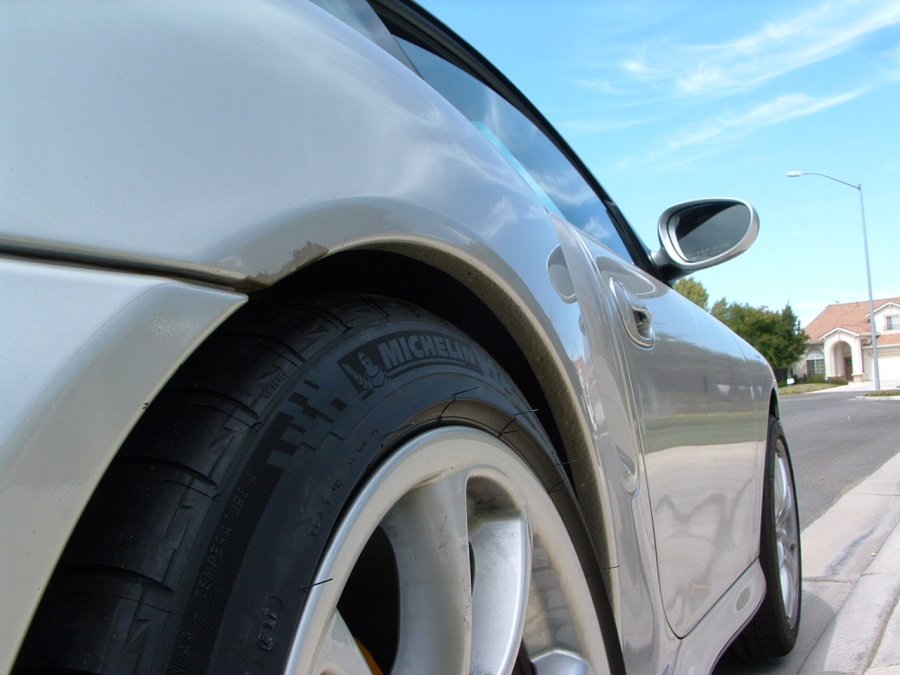

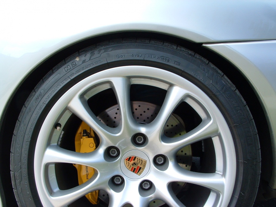

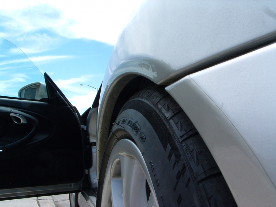

Okay guys, these pics are of my rear 315/40/18's on 12" GT2 wheels w/ 7mm spacers. You can't see it, but I backed the car up on the curb on both sides (except for the first 2 pics) to get as much compression as the car would allow.

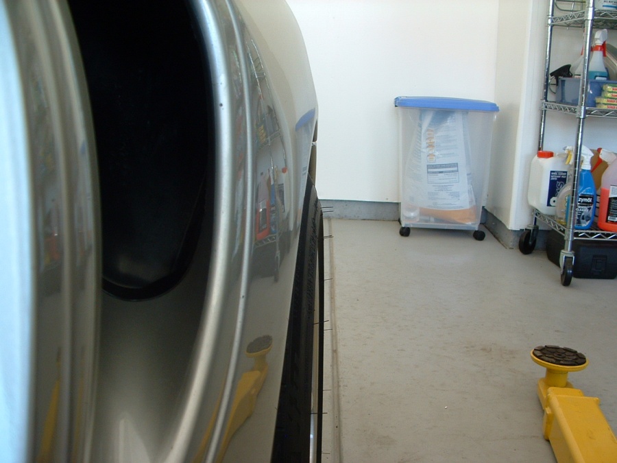

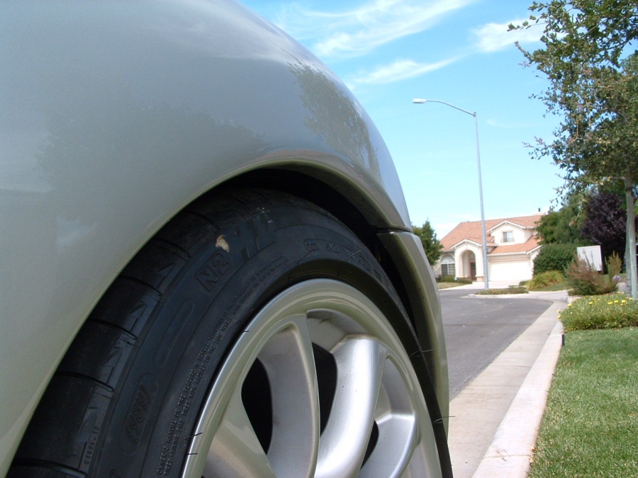

Old Aug 31, 2009 | 03:30 PM
dtmarsh's Avatar

Old Aug 31, 2009 | 05:07 PM

Your fenders aren't rolled right?

dtmarsh has much to be proud ofdtmarsh has much to be proud ofdtmarsh has much to be proud ofdtmarsh has much to be proud ofdtmarsh has much to be proud ofdtmarsh has much to be proud ofdtmarsh has much to be proud ofdtmarsh has much to be proud ofdtmarsh has much to be proud of
That's correct. Since I'm running 7mm spacers now and have just minimal rubbing on the wheel-liner on the driver side, maybe 10mm spacers are the answer.
