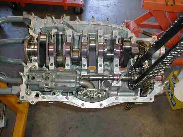

Yes, this is very normal. We don't have an oil pan if you will and the oil is continually pumped through the system. The tank will pass oil through it and the dip stick will catch the stream and show the level. It has been this way since 1965. The oil will flow through the coolers once the car has come up to operating temp and will allow all the thermostat to open thus creating maximum flow through the system. this is when you check your levels. What makes me jiggy is I have owned 30 Porsche. All of which have had a dip stick. The 996TT is without one and I have to rely on the computer. Just not use to that. This is the only way to check the oil in a dry sump system.
This is basically what the inside of your case looks like. The oil pump is in the bottom with the screen on it driven by the int. shaft.
