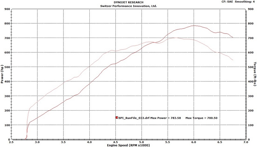

evoviiiyou's Avatar
Joined: Sep 2007
Posts: 774
From: Ohio
Rep Power: 57
evoviiiyou is a splendid one to beholdevoviiiyou is a splendid one to beholdevoviiiyou is a splendid one to beholdevoviiiyou is a splendid one to beholdevoviiiyou is a splendid one to beholdevoviiiyou is a splendid one to beholdevoviiiyou is a splendid one to behold
Switzer 997 GT2 P800/R850 and of course the Sledgehammer.
P800 GT2
http://www.youtube.com/watch?v=7vIZLlWP_FM
R850 GT2
see attached for dyno sheet (sorry could not find vid)
