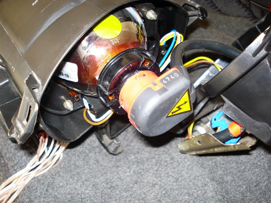

Yesterday my new ballast came in, of course the guy sent the wrong part, so I decided to swap ballasts from the good side to the bad side, same issue, so it I have now confirmed it is NOT THE BALLAST.
So, then it gets more strange. Once I determined it was not the ballast, I took the assembly back out, checked everything back over, cleaned the terminals again, slid it back in, started the car and the damn lights (both) came on. Turned them off, went to turn them back on and the bad one is still bad.
At this point, it has to be the starter/ignitor misfiring or not getting enough voltage to the actual ballast, is that a stretch? Anyone ever have to replace an ignitor?
I can tell you this much, I am now a pro at taking apart anything headlamp related and am sick about the fact that this little thing is kicking my butt.

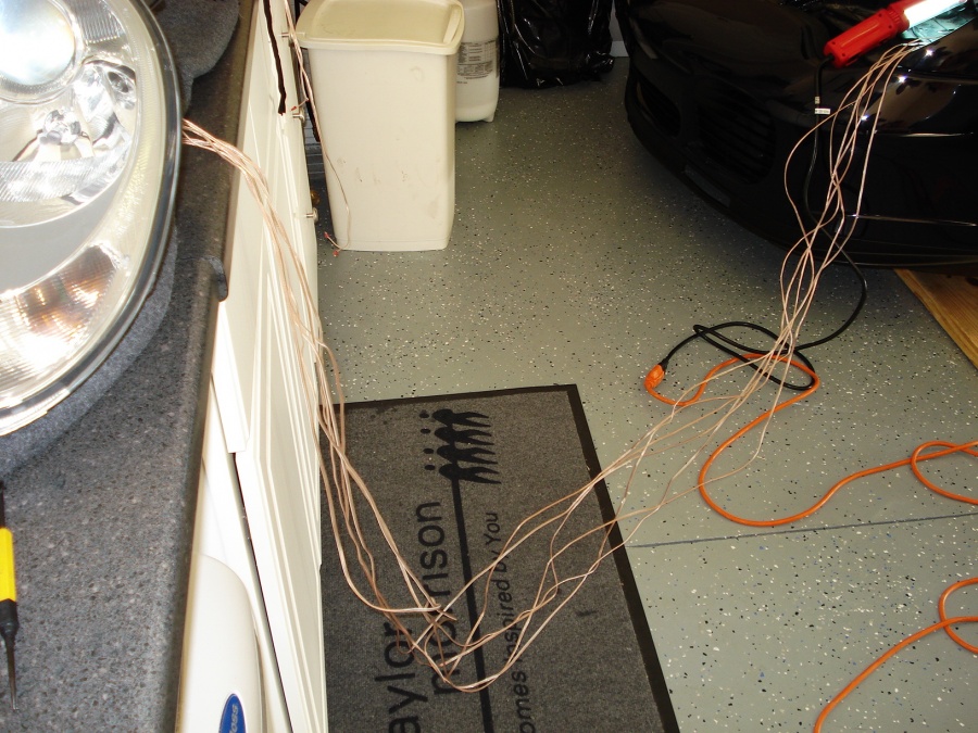

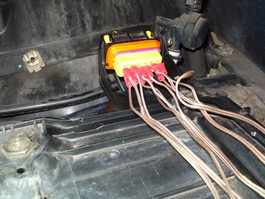

When you remove the headlamp assembly, dosconnect the ballast from the back of the assembly and disconnet the connector that goes on the back of the Xenon bulb.
At this point, the only thing holding you back is the rectangle shaped plastic piece that retains the cable running from the ballast to the Xenon bulb connector, this piece is held in by 4 plastic prongs that you need to work at (carefully) trying not to break the tabs, but depressing them inward so they release. Work each tab individually until it comes free, then the entire ballast and connector will come free.
I simply took one ballast assembly from the passenger side and put it in the drivers side (they are identical).
Today, I am making 5 foot extensions to run from the female plug to my headlamp assembly which will be sitting on my workbench. This way I can wiggle the actual yellow/orange connector in the back where the headlamp mates to the female plug without having to remove any part of my fender or inner fender.

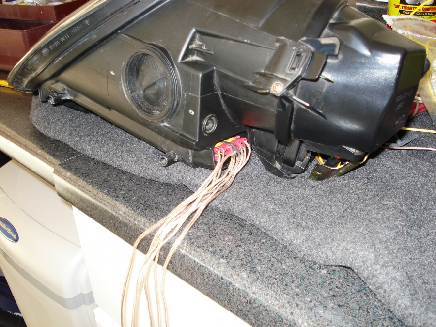

Took the passenger "good" ballast out and moved it to the "bad" side and the "bad" ballast to the passenger "good" side... the passenger side still works with the other ballast in (so the ballast is NOT bad).
Currently, I have the headlamp sitting on my work bench extended with 10 foot leads so I can check all items with the headlamp out and:
1. Tried to get the headlamps to come on with only the accessories on = lamp does not light.
2. Then started the car with the same set-up as above, the headlamp came on for about 1 second, then off.

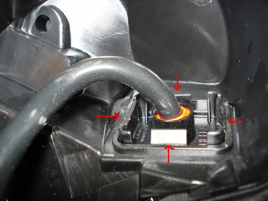

Someone asked earlier about how to get the ballast out - there is a pic showing the 4 plastic tabs that need to be carefully depressed at the same time (be patient).
Thanks a bunch. Yea. I got that figured out but I didn't want to cut the wire to get the little cover off the wire (my real question). Ultimately, I had to do it. Here is what I did for a $70 (a pair) replacement of HID Ballast.
http://lotususa.com/Alex/996FactoryBallastReplace/
