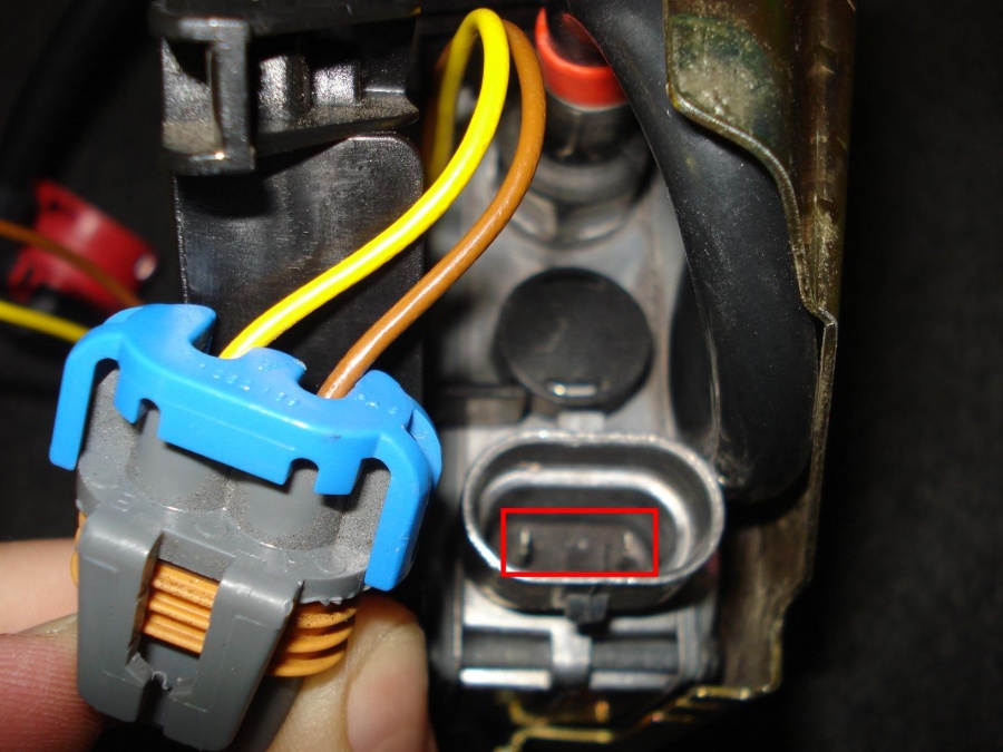

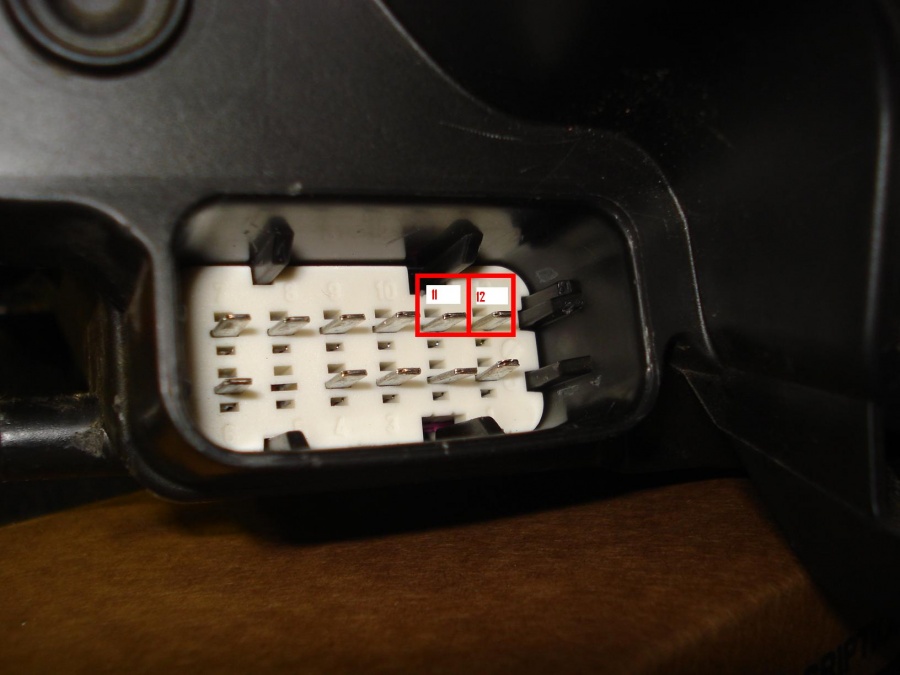

Today, after Thanksgiving meal, I wandered out to the garage for some more troubleshooting. I put the headlamp on my work bench and extended it again with the 10 foot leads that I made.
This time, instead of connecting the wires from the car to pins 11 & 12 (PICTURE #1) to the normal male connector, I bypassed the connector and went directly to the ballast input (PICTURE #2), started the car, turned on the switch and the low beam comes on and works PERFECTLY 10 times in a row.
So, the issue is somewhere between pin 11/12 and where it enters the input side of the ballast.
Is there ANYONE that services headlamp assemblies? This thing internally is pretty complex and getting to the backside of the connector that pins 11/12 are on is tough because of where it physically is.
