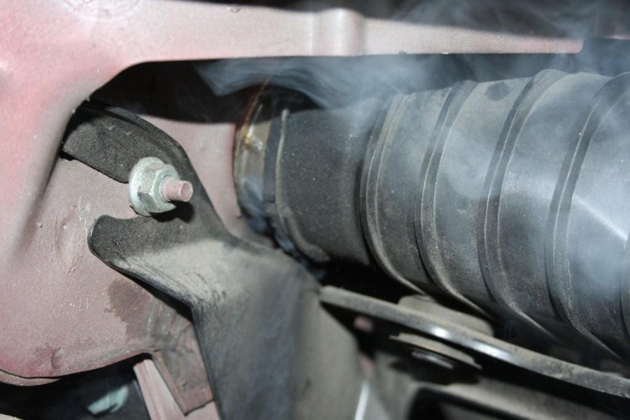

Here's a pic of the smoke/pressure test showing the leak at the intercooler. No, it's not on fire. He mixes smoke with the air to make it easier to find the leaks. I posted this once before, but since you asked... Photo on the left is to orient you, the one ofn the right gives a closeup of the leaking connection.
I'll take some photos of the new hoses and post them later.

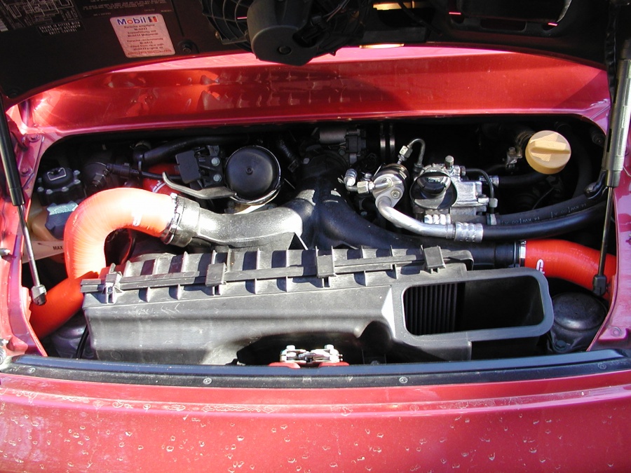

Here are some more photos. First one shows the new boost hoses.
The next two show coil packs. The one on the bottom (first photo) and right (second photo) came from the right side, the other from the left. If you look carefully, you can see the track of exhaust soot up the shaft, and it is clearly visible on the top of the coil pack. You can't even read the P/N through the soot.
The plugs were installed after a leak-down test during a PPI 20k miles ago. By a dealer! I won't mention the name, but the owner runs 4 NASCAR teams that are at the top of the standings this year.
