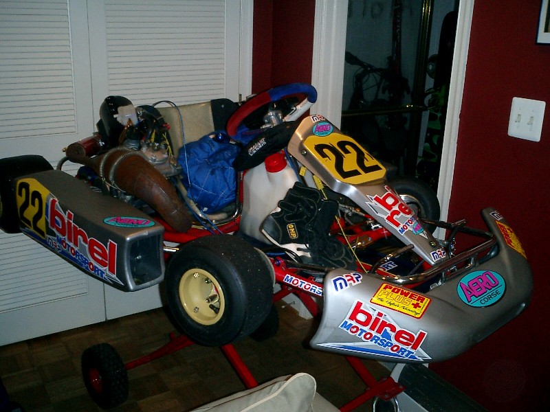

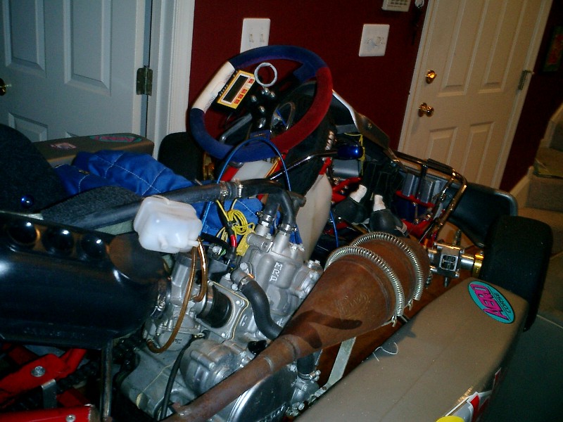

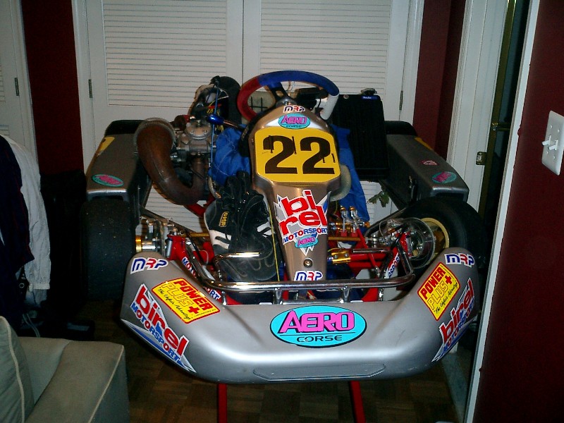

If theres no classes available for rotax or easy karts which are the best to learn on, it is very possible to learn on shifters. The only dowside to shifters is that karting takes a lot of concentration when learning. There are many skills to be mastered that are very demanding such as proper braking, drafting, turn-ins and exits, proper lines, as well as doing this at 90+mph with other racers and your adrenaline soaring can be very difficult the first couple of times. Add shifting to this equation and you can definately confuse yourself or even distract yourself enough to end up against the tire walls. I highly recommend you get an instructor the first couple of times and take it one step at a time. Also, take the time to learn your kart. there are limitless possibilities of engine tuning, camber, caster, and toe settings as well as brake bias etc. that can affect handling and make the cart faster and easier to drive. Here are a couple of pics of my birel. Its a 125cc honda motor and i added a tach that gives me speed, revs, engine/transmission temps, as well as lap times. This is a great chassis and the engine is extremely reliable with the proper maintenace.

another angle

yet another
