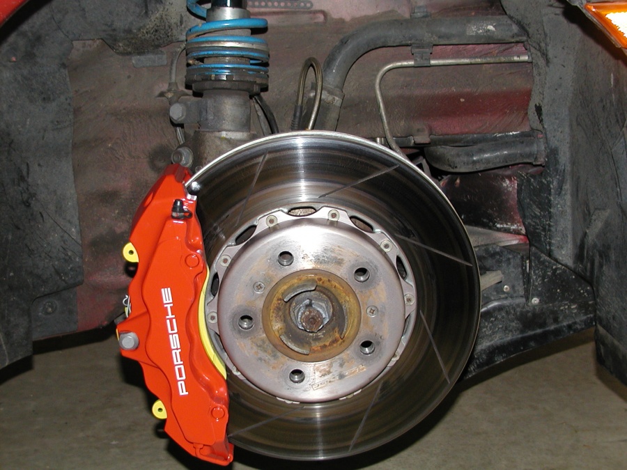

Maybe you can. I know that I couldn't. Trust me, I tried.
Setting toe really is not all that hard. If you want to do it by counting turns without measuring, it adds 5 minutes per side when you change the pads. Loosen the 21mm jam nut, crank the requisite number of turns with a 13 mm open-end, and retighten the jam nut. It's easy to reach from the fenderwell when the wheel is off.
So even with a 60mm/2.5" spring it'll contact the fender well before you can get to -2.5 camber with a set of upper camber plates?
Again, I tried and could not do it. Others here seem to be able to, others not. I really don't know why some can and some can't. The upper camber plate doesn't help when the strut is hitting the fender.
I think that my front springs are 3.5" in diameter. Too cold to go out and measure, but scaling from the photo below, where the rotor is 350mm, I get 3.5". Maybe a 2.5" diameter spring would work.

Most coilovers use either a 60mm or a 2.5" spring. I'd be really surprised if your springs were 3.5" in diameter.
I'm surprised to hear that there's so little room that the springs contact the fender well.
That should make things interesting...
