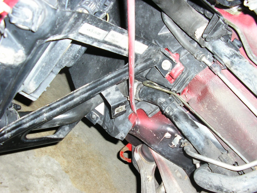

OK, cleaned off everything and took it for a ride.
When I came back, I saw leaks at the top and bottom of both radiators, where the hoses come in (back of the radiators, away from the front of the car). Would that indicate O rings ?
Attached pictures show all 4 points.
Anybody had a similar experience ? Recommended fix ? I'm leaving for a business trip on Monday and this is my daily driver, so I would have to drive it to the airport. Should I order a limo and leave the car home ?
You gotta keep taking bolts off until you see the problem. The radiators hang on a bracket. You can unbolt the bracket and let the radiator hang by the bracket so you can see all around it. I don't think you should drive it if it's leaking that bad, from 2 sides no less?

Similar problem here. Could be just the O-ring seal at the radiator hose. Most coolant leaks occur only under pressure, so your experience with removing the radiator cap makes sense, but isn't helpful for diagnosis.
Here is what I recommend that you do:
> Remove RF tire and inner front fender liner. The liner comes out with 5 torx head screws (4 in front of the tire, one at the front underneath where the fender liner meets the bumper cover), one philips head screw where the chin spoiler meets the fender liner at the bottom, and one plastic push-in plug underneath the signal light. Pop out the signal light by gently prying it out and forward from the back to reveal the plug. Pry it out with a screwdriver and a little swearing (at least that works for me.)
> Borrow or buy a pressure tester. Remove the radiator cap and replace with the tester. Pump it up to 15 psi and go watch where the leak is coming from.
GL and I hope it' a hose fitting. Replaced my O-rings, and it seems to be fine.
Jon

Originally Posted by code7rpd
Can the radiator hoses be replaced by removing the fender liners?
Yes - at least for the outboard radiators. Not the center one, though. In my car, we just replaced the O-rings in the connectors at the radiators. See the photo below of the LF. You can see the entire lower hose, and one end of the top one. The other end of the top is equally accessible.
Jon
Jon
How did you know the o rings was the problem?? was the leak at the rad compler hose connections.
The manuals says there is 5 liters of fluid going to come out when you take off the compler hose, is a large amount of fluid going to come out when i release the clips ad pull of the hose?
I can't answer the first question, but the answer to the second one is yes. You'll get over a gallon come out. Have a bucket ready. I chose to strain and reuse it.
When the system was pressurized, antifreeze started peeing out at the connector. Before you do this job, search around a bit for details on how to fill and bleed the cooling system. One of the many things on this car that is a PITA.
