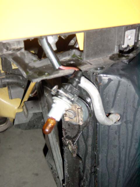

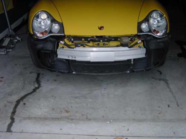

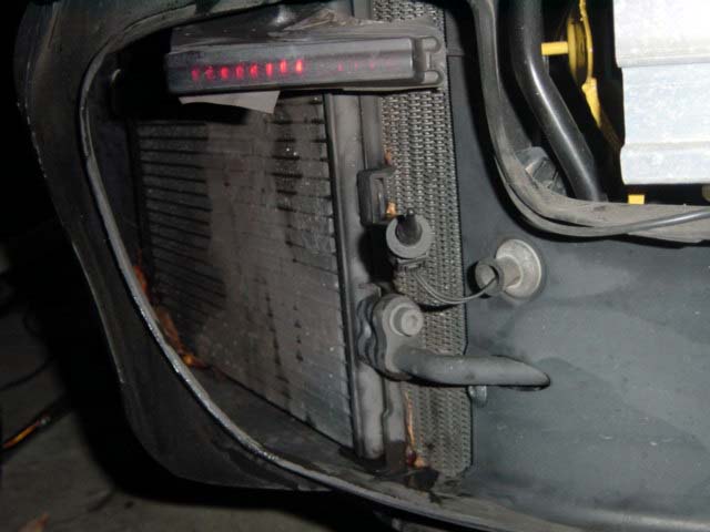

All,
Some of you might have read my previous post about the coolant leak at the front of my car. I started removing some stuff today and took some pictures. See attached.
Can somebody please help me assess as to how bad this damage would be ? Are we talking hoses or radiator unit ? What to look for ?
Got leaks on both sides, but the passenger side is really bad...
Thanks !
Yves

Can you tell where it's leaking from? Core? Hoses? Fittings? Take the radiator right out if you can't see where the leak is coming from. New radiators are around $400 each, if you need one. You gotta bleed them anyway, might as well take it out and see what the problem is?

Can't immediately see where it comes from. Quite some 'spray'. No real clear origin.
I would spray it all down with brake clean or something fairly strong to get it clean and let it run and get hot to see where it leaks from...

Well...good morning everybody and happy new year !
Just had a look in the garage and things did not look too good this morning. Car has been crying all night (see picture), more so on the passenger side.
Kind of surprising for such an expensive car. Second year of ownership and already had to deal with the slave/accumulator and now this...

Remove the inner fender, jack up the front and remove the plastic under cover and see where the wet starts. See if it is a hose, loose fitting or the radiator itself is bad. You could need a left and right radiator or you could just need a couple O-rings or tighten a fitting? Hopefully the latter...
