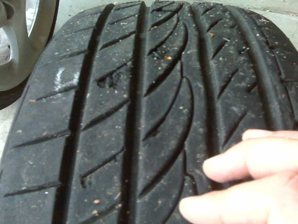

I have posted this before....sumi's+high heat = PSI over 50 = trashed tires...these had a few thousand miles on them - and 3 brutal track days

Classic over inflation symptoms.

That was after I let 8 lbs out and then drove like runaway bank robber...The Sumi's just can't deal with heat so the presure goes up and up and up....lol
