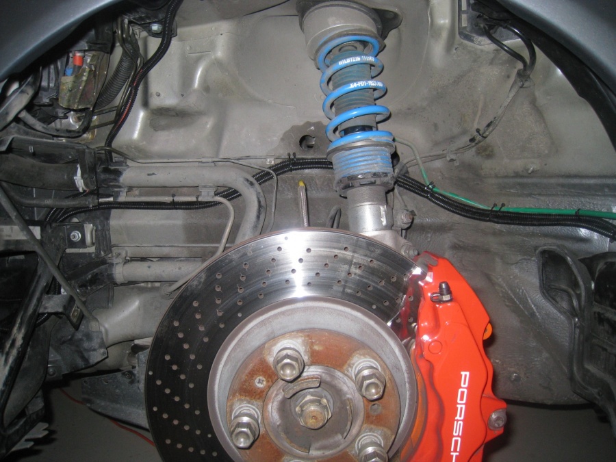

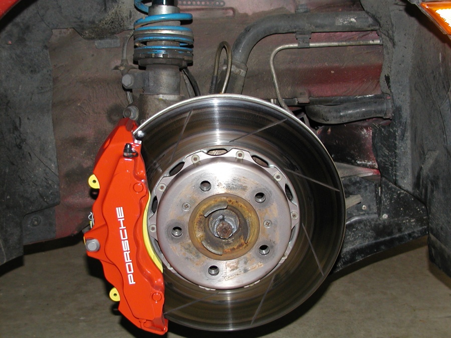

Here's a photo that lets you see the adjustment nuts. Just at the bottom of the blue spring. You do need a special spanner to turn it. My alignment shop had one.
Fast FWD---It appears that you have switched the rear helper springs to the front..based on the photo. Your front only has 4 coils on the helper and the spring pearch is the wider rear unit. Compare the other photo from BigBadBen.
I have thought of doing this since the front has 6 coils it is "taller" than the rear 4 coils. There are plenty of threads on the rear shock tube so it could handle the taller helper. The front with the 4 coil as you have it would allow for more adjustably. I have read that both helpers have the same spring rate of 150 lbs so there should be no issue with load.
I wondered if there was something wrong with my set. I have the fronts all the way down and I only got .5" drop. Whereas the back threaded lock rings have 3" to go down. If they are swapped the front could gain and 1" of travel down and the rears would be in the middle of their adjustment range up or down--and yes I have read every thread here on PSS9/10 lowering limitations.
Did you install your Bilsteins intentionally this way?

Originally Posted by LO_996tt
Fast FWD---It appears that you have switched the rear helper springs to the front..based on the photo. Your front only has 4 coils on the helper and the spring pearch is the wider rear unit. Compare the other photo from BigBadBen...
The photo that you see is the way that the PSS9's came when I bought the car. I don't know if they were switched or not. You may notice that the springs are all the way down at the end of the adjustment, so that was as low as the car would go, and it really wasn't as low as I wanted it to be.
I just got done replacing the original springs with stiffer ones (225/515) lb/in originally, now (450/670) front/rear. (Also had the shocks revalved.) I had to buy springs 1 inch shorter than the originals for the front in order to drop the ride height where I wanted it. I used the same helper springs that were already there. As Tim points out, they are bound when the car is loaded. They just keep the main spring seated on the perch.
I bought the springs from Swift. IIRC, the fronts are 70-158-080 and the rears were 70-200-120. The numbers mean (ID -in mm)-(length in mm)-(rate in kg/mm).
I won't really know how well this worked until I get on track, and that's not until Mid-Ohio in April. :-(
Hope that helps.
Jon
